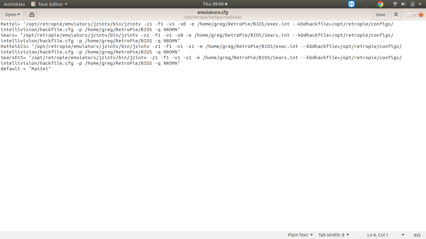

      How should i set up my /opt/retropie/configs/intellivision/emulators.cfg?
      You should set up 2 different settings. 1 for the ECS games and 1 for everything else. The best way is to have it set up like this:
      jzintv="/opt/retropie/emulators/jzintv/bin/jzintv -v1 --kbdhackfile=/opt/retropie/configs/intellivision/hackfile.cfg -f1 -q -p /home/pi/RetroPie/BIOS %ROM%"
      default = "jzintv"
      jzintvecs="/opt/retropie/emulators/jzintv/bin/jzintv -v1 -s1 --kbdhackfile=/opt/retropie/configs/intellivision/hackfile.cfg -f1 -q -p /home/pi/RetroPie/BIOS %ROM%"
      The -v1 enables intellivoice. This can stay activated as it has no drawbacks to games that dont use it. Then you never have to worry about it.
      The -s1 enables the ECS. you dont really want this always enabled, hence the need for a second config.
      My picture looks really fuzzy and crappy. How can i make it sharp and use the full screen?
      In your emulators.cfg you can add a -z option to the configs for the resolution you are using. an example would be for a 1080p/i resolution: It would be -z1920x1080, So in the emulators.cfg file you would edit both configs like this:
      jzintv="/opt/retropie/emulators/jzintv/bin/jzintv -v1 --kbdhackfile=/opt/retropie/configs/intellivision/hackfile.cfg -z1920x1080, -f1 -q -p /home/pi/RetroPie/BIOS %ROM%"
      default = "jzintv"
      jzintvecs="/opt/retropie/emulators/jzintv/bin/jzintv -v1 -s1 --kbdhackfile=/opt/retropie/configs/intellivision/hackfile.cfg -z1920x1080, -f1 -q -p /home/pi/RetroPie/BIOS %ROM%"

              dudleydes @edmaul69
              @edmaul69 You can avoid any permission issues by adding -p /home/pi/RetroPie/BIOS to the jzintv launch command. This is how the scriptmodule currently configures jzintv. I have tested it with the jzintv binary available from intellivision.us and the extra flag works without issue.
              It's also worth pointing out that the BIOS files, exec.bin and grom.bin, need to have file names in lower case as Linux is case sensitive. Here is a thread where this was discussed. This doesn't seem to be an issue for intellivoice BIOS file. Mine is named IntelliVoice BIOS (1981)(Mattel).bin and it works fine. I haven't tested the ECS BIOS.
