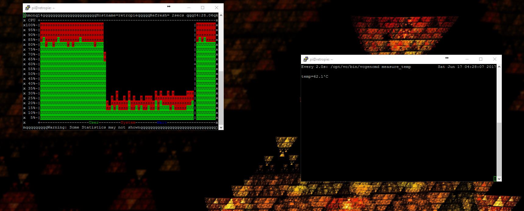

          For my first test format I went with AVI 320x240, mp3 128k, Mono, 60fps. Now I know that 60fps is high for this board, but I wanted to build a historical frame of reference.
          I am using nmon to monitor the CPU and watch /opt/vc/bin/vcgencmd measure_temp to measure the temp actively. I am attaching below the behavior being seen.
          Graphic 1 shows that I booted the Zero to the systems carousel in ES. Switching menus you see the first spike as I going into my NES system. I immediately go into a game before allowing a video snap to parse. I am using lr-quicknes as my emulator. The second set of spikes are the emulator process beginning and then the next several intervals are gameplay. During gameplay I am sitting at around 62-63 C. I have my board in a Pi Cart and have a Microcenter heatsink on the CPU. When I exit the game and go back to ES we see another spike.

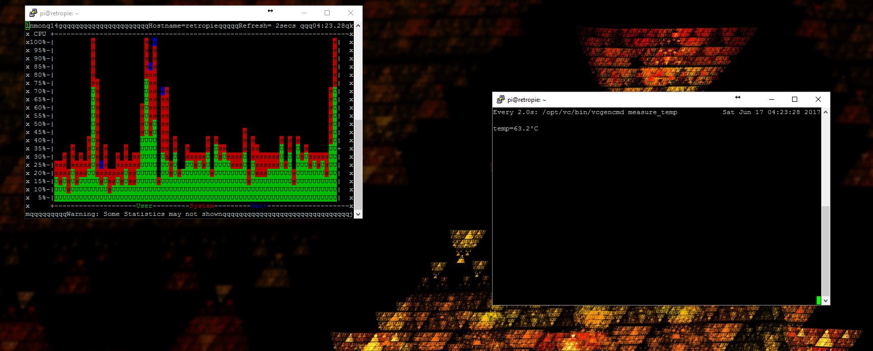

          At this point I am letting OMXplayer parse the newly created .avi file. With .mp4 files (320x240, AAC, 128k, Mono, 30fps) that I have from my Rpi3 builds it takes roughly 5-7 seconds for the video to begin playing. The .avi file is however a different story. It takes 9-11 seconds before the file begins playing and as you can see the CPU spikes and stays there. After several intervals I enter back into the game and as you can see since the OMXplayer process I am assuming ends the CPU drops. I then exited the game after a short period and then allow for the video snaps to load again however this time I go from the .avi to the .mp4 then go to the main systems carousel and allow the board to sit at that screen for a decent period of time. During this time the CPU does not drop which leads me to believe that the OMXplayer process either hangs or still runs in the background. Also during this time the temp as you can see climbs to 69 C.

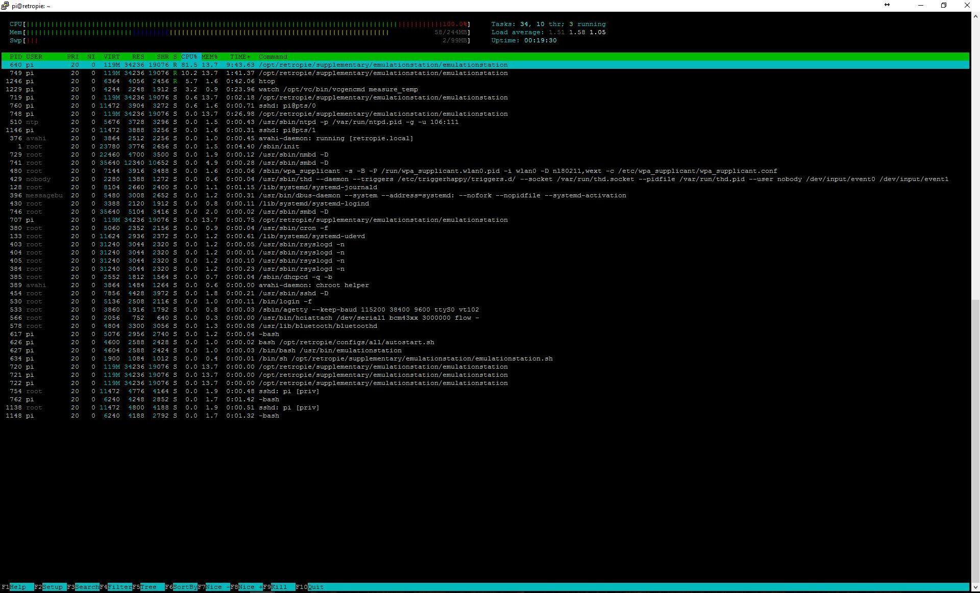

          I then performed a reboot. As you can see the CPU stays pegged during and then after the reboot sitting at the main systems carousel. The temp however dips back down into the low 60s. I then went back into NES and started 1943 once again which drops the CPU and keeps it at an expected avg % of around 30.
