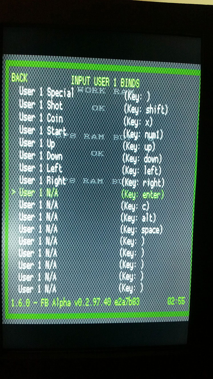

                        @caver01 Here is a screenshot of the retroarch input configuration menu while in the fba core.

                            caver01 @golaat last edited by
                            @golaat interesting that it has SHOT, but your enter key is set to an input that is N/A. What game is this for?

                            • golaat
                              golaat @caver01 last edited by
                              @caver01 that is 1941.
