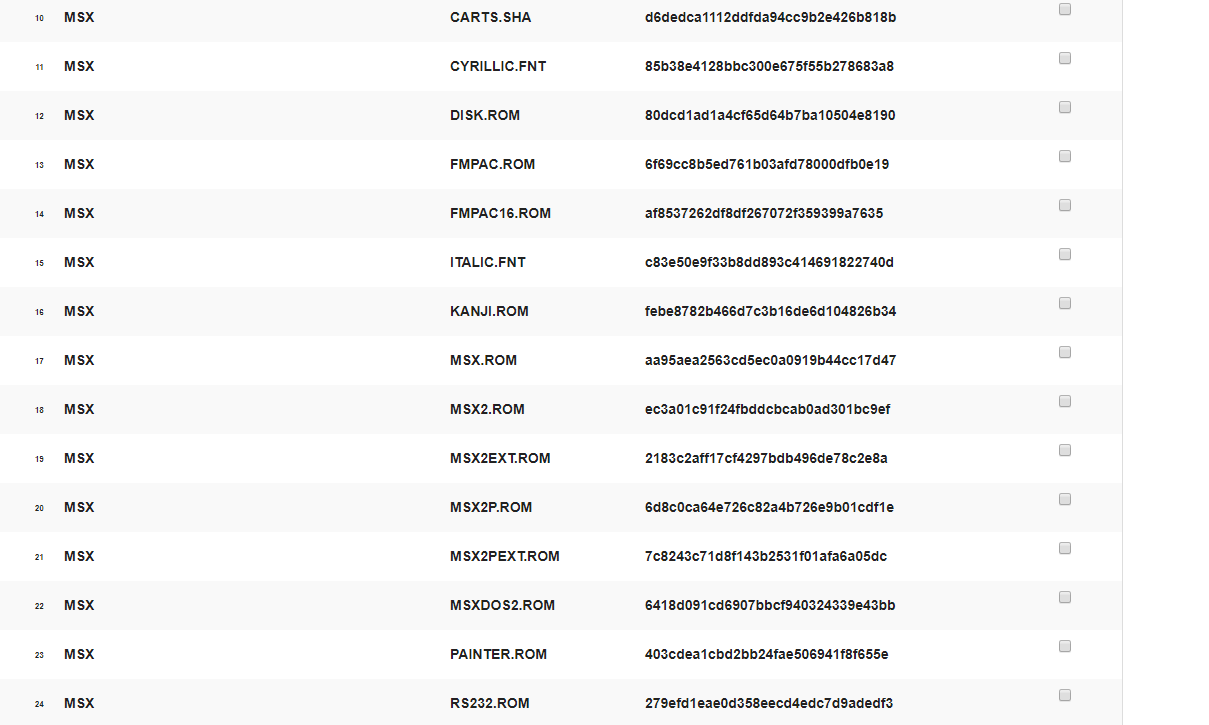

                            @shizzmoney and you have all the proper bios files?
                            ShizzmoneyS 1 Reply Last reply Reply Quote 0
                            • ShizzmoneyS
                              Shizzmoney @herb_fargus
                              @herb_fargus yeah (this is via retropie manager)

                                          Parameters:
                                          Executing: /opt/retropie/emulators/retroarch/bin/retroarch -L /opt/retropie/libretrocores/lr-fmsx/fmsx_libretro.so --config /opt/retropie/configs/msx/retroarch.cfg "/home/pi/RetroPie/roms/msx/Aleste (1988)(Compile)(JP).dsk" --appendconfig /dev/shm/retroarch.cfg
                                          Allocating 16kB for empty space...
                                          Opening MSX2.ROM...FAILED
                                          Opening MSX2EXT.ROM...FAILED
                                          Opening DISK.ROM...FAILED
                                          Allocating 128kB for RAM...OK
                                          Allocating 128kB for VRAM...OK
                                          Mode 268501010, RAMPages 8, VRAMPages 8
                                          maybe those are the files. weird though b.c the retropie manager says they are the correct ones!
                                          edmaul69E herb_fargusH 2 Replies Last reply Reply Quote 0
                                            edmaul69 @Shizzmoney
                                            @shizzmoney you werent logged in as root when you added them? You could try giving 0777 permissions to those files and see if that does anything
