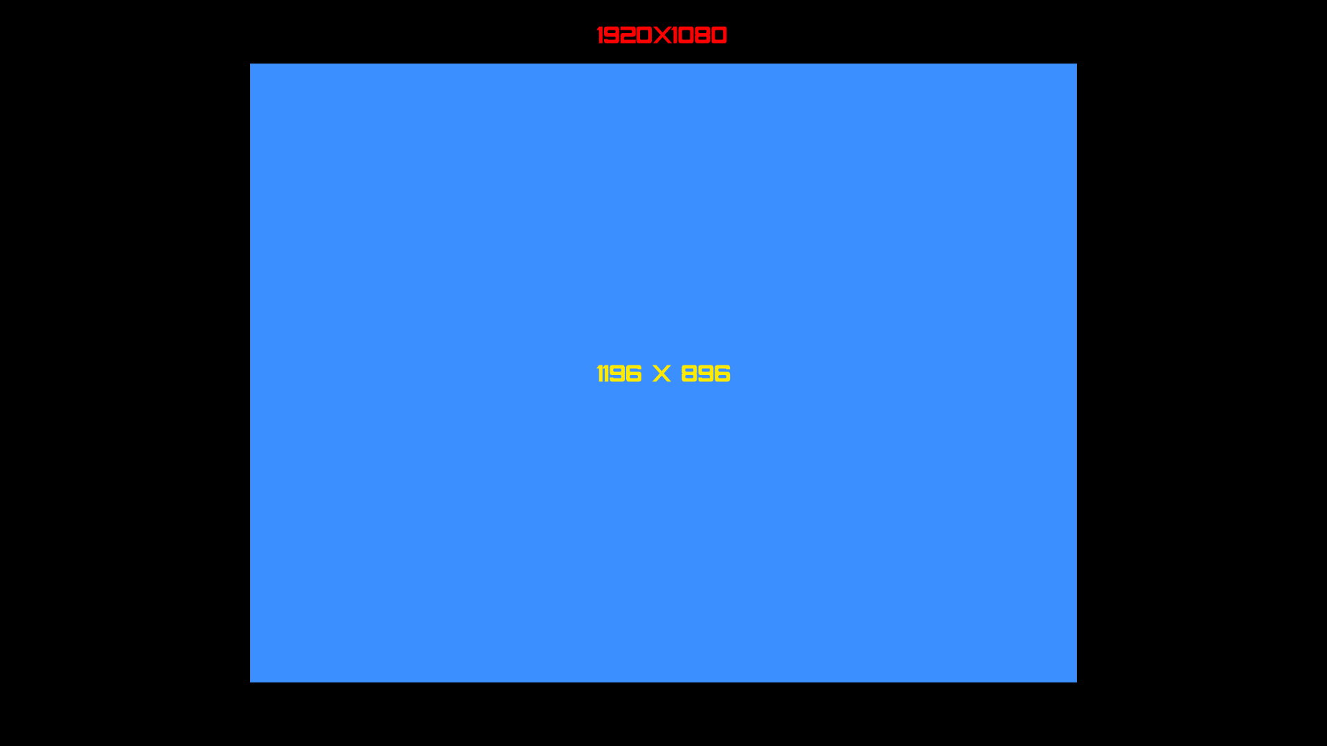

                      You're probably better setting up your own custom size and pos in the NES retroarch.cfg with.
                      custom_viewport_width =
                      custom_viewport_height =
                      custom_viewport_x =
                      custom_viewport_y =
                      Then adjusting the overlay with something similar to this. This can save the head aches of random size variation and mis- alignment. Also alot of people who create Bezel overlays don't seem to center them properly as well. Which is why it's probably better off making it yourself.
