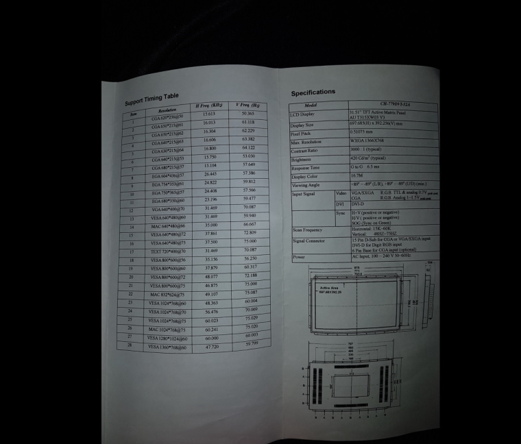

      Hi all,
      I have a sync query regarding connecting retropie to a multi-sync monitor via VGA
      I have a tri-sync Rodotron arcade monitor:
      monitor page
      Also image of user guide timings:
      From my understanding, I need to output this at 240p. My rodotron is connected to the pi via a HDMI-VGA adaptor.
      After reading many forum posts (some seem to be from before Pi could output at 240p). I'm wondering if I only need the VGA adapter? From what I've read, I no longer need a VGA downscaler, I can set the Pi to HDMI mode 8 for 240p 15khz and its good to go.
      Does anyone know if that will be suitable for my monitor?
      The thing that is throwing me off is whether my monitor is classed as CEA or DMT. Most posts I've found point to using HDMI group 1, mode 8 for 240p, but this may be for people using normal old tv's and mode 9 seems to be the widescreen version, not 8.
      If my monitor is classed as DMT , i cant see any modes int he following list that correspond to 15khz, 240p:
      video mode options
      Any help for a noob would be greatly appreciated. Also if you feel a different resolution that my monitor can handle would be better for MAME/SNES/psx on an arcade cab, then please feel free to recommend.
      Cheers

        Eventually this tutorial will help you: http://retrorgb.com/rpi240p.html

          @ldonohue85 Have you seen these options?
          Pi2Jamma
          Gert's Vga Adapter
