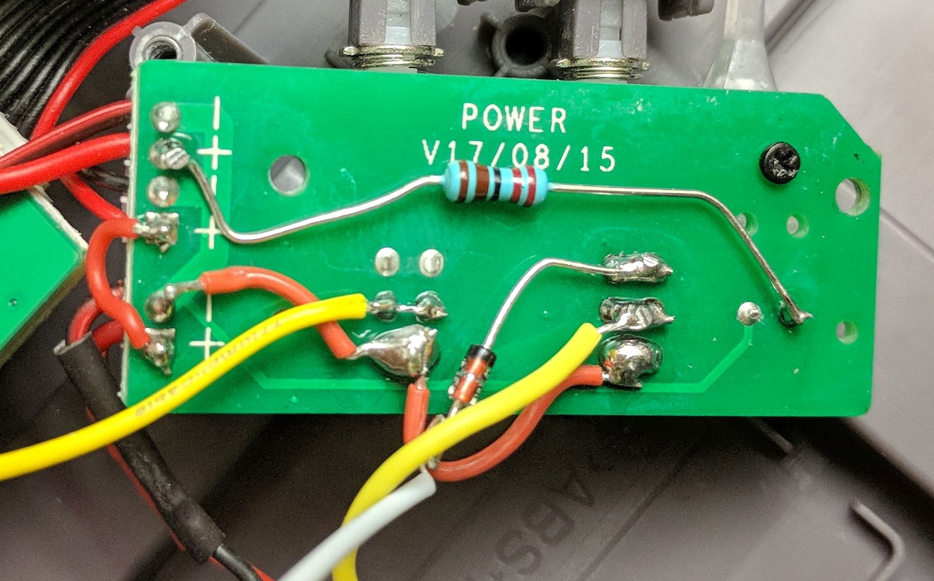

                                    I built the thing yesterday and sadly it didn't start. The RPi didn't get any power at all.
                                    I followed your instructions exactly, apart from using another capacitor that I had lying around. I used one rated for 330uF 25V. Could this be the reason or do I have to start troubleshooting?
                                    YahmezY 1 Reply Last reply Reply Quote 0
                                    • I
                                      iggy
                                      @schnautz Would you be able to take picture of all your solder connections, etc? The sizing of the cap is fine although you need to observe polarity when soldering on the mosfet board.
                                        schnautz @iggy
                                        @iggy Thanks for your swift reply.
                                        I checked the polarity of the capacitor, but thanks for the tip.
                                        I realize my severed connections look pretty messy. But for quite some time they were still connected when I checked them for continuity.
                                        I 1 Reply Last reply Reply Quote 0

                                          @schnautz Your capacitor should be fine as long as it fits ok. Is it still not running? If not what happens exactly? Does the led on the front of the case turn on?

                                            iggy @schnautz
                                            @schnautz
                                            K i see whats wrong...for Vin and Vout, you neg wires need to be connected to the pad that says GND on the mosfet board.....currently, for Vin, your neg lead is connect to both pads labeled Vin. Same with Vout. Have a look at Yahmez's pics to see what Im talkin bout .
