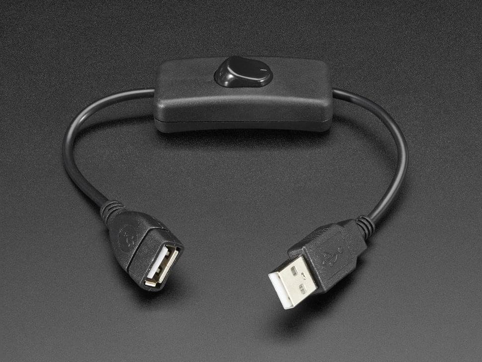

        When you supply power (via the USB connector) to the Pi, it will turn on. After use, you can switch it to a low power mode using sudo shutdown -now but that is not really turning it off, just safe to remove the power (unplugging it). Very similar to a standby mode, except that you will need to supply power to one of the GPIO pins to have the pi wake up, as opposed to using a remote control.
        Now, turning it on via whatever interface, means what exactly? You want to be able to wake it up from the low power mode, or you want to supply power to it using this interface? You could maybe fabricobble an ardiuno-setup that drives a relais circuit connecting/cutting the power based on whatever input, but I have the feeling you are aiming for something less involved. Maybe something like this will work for your setup?
