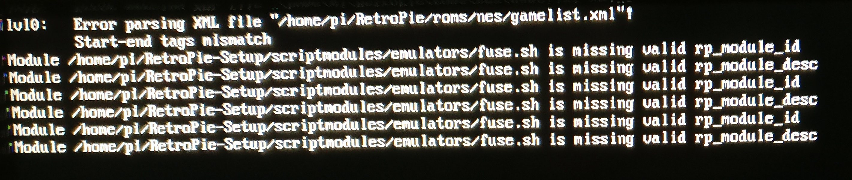

      Hi guys,
      My system and roms work perfectly however i have just noticed i cannot access any sub menus in the retropie settings (es themes,wifi,retroarch etc.) and get this error message. I have managed to solve the gamelist.xml error but the missing valid rp issue persists. Any help would be appreciated. Thanks.

        Please read this post and provide the necessary information: https://retropie.org.uk/forum/topic/3/read-this-first
        Not sure what version your running. You could try accessing the setup through command line.
        sudo ~/RetroPie-Setup/retropie_setup.sh
          BuZz administrators
          looks like your fuse.sh is corrupted. Have you edited any of the files manually ? You should check the contents of the file referenced - could be sdcard corruption.
