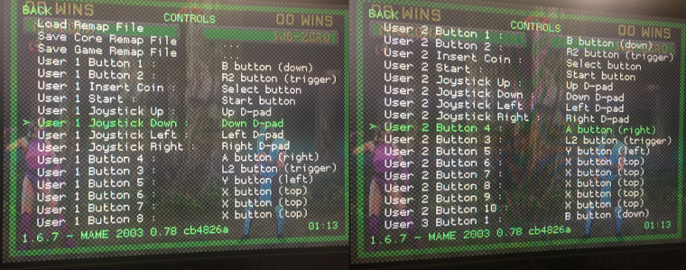

      In several games using Mame 2003, I have successfully pressed Select + X and used RetroArch to remap buttons to make the games playable for Player 1 with my button layout.
      The problem is that Player 2 (set up identically in RetroArch and Emulation Station) does not follow the button mapping and I'm not sure where the discrepancy is coming from. You can see in the photos the button config for both identical joypads is identical, and you will have to trust me that the Emulation Station mappings were also done identically.

                        Ok, thanks for your help, I've done a whole heap more testing and documenting and I discovered the problem seems to be limited to Mame2003
                        The joysticks say Dragonrise USB when the games load, if that helps.

                        However, when Mame2003 loads the button mapping for each Joystick is different - this is the frustrating problem

                          Hello All,
                          This is still unsolved, but there is another clue that it is not a hardware problem:
                          When the USB plugs for Player 1 joystick and Player 2 joystick are reversed, Player 2 joystick takes on the Role of Player 1 and behaves as it should and Player 1 takes on the Role of Player 2 and its buttons are all messed up. Therefore, this is not a hardware problem, but rather a config problem.
                          I am lost with all the configurations in RetroPie. If someone knows the likely location of the config file I need to edit, it would be great if they could pass on this information.

                                @shay90 said in Joystick P1 and P2 Discrepancy despite identical setup:
                                @crumbs Hi Crumbs. I recently had a similar issue. Deleting the retroarch.cfg for that emulator should fix it! Reboot Your Pi and it will be re-created.
                                close, but no.
                                1. delete the retroarch.cfg file for the emulator (ie /opt/retropie/configs/SYSTEM/retroarch.cfg where SYSTEM is the folder name you launch mame2003 games from)
                                2. IMMEDIATELY update lr-mame2003 via https://retropie.org.uk/docs/Updating-RetroPie/#updatinginstalling-individual-packages
                                step 2) is important because it recreates retropie's default retroarch.cfg for the system. this will ensure all the default bindings are linked up correctly, and a bunch of other stuff. without that you'll end up with a retroarch default, which is not what you want.

                                    Well no. It definitely rebuilt the config in mame-libretro (the folder I use for MAME ROMs), but the problem persists, even after restarting the system. It must be due to another config in another location somewhere.
                                    At any rate, I guess I will just continue with the rebuild as this solves the problem.

                                        dankcushions Global Moderator @crumbs
                                        @crumbs said in Joystick P1 and P2 Discrepancy despite identical setup:
                                        there are a couple of places you can check
                                        /opt/retrepie/configs/all/retroarch/config/ (look for mame 2003 files or folders - delete them)
                                        /opt/retrepie/configs/all/retroarch/config/remap (look for mame 2003 or mame game files or folders - delete them)
