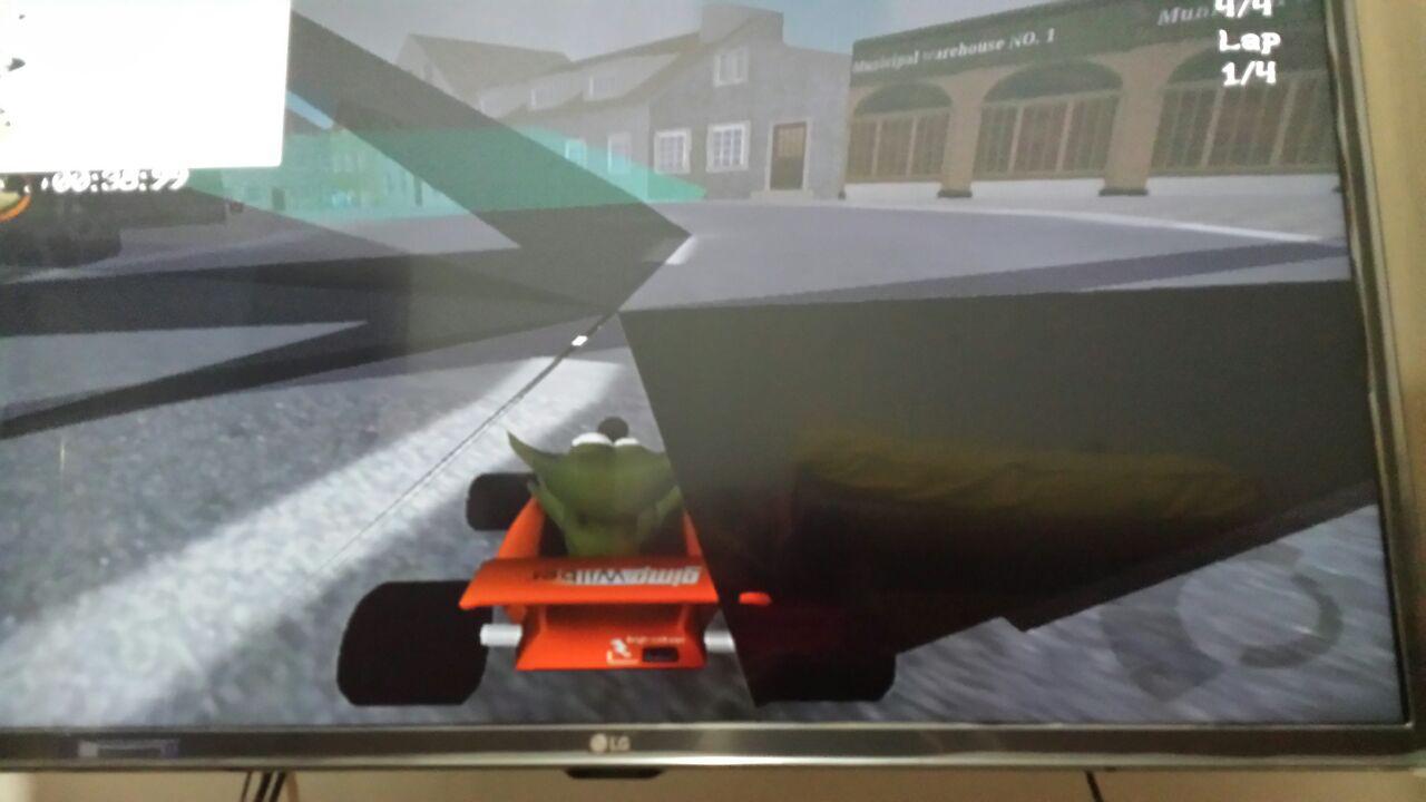

      Hello everybody! I installed SuperTuxKart on Retropie after downloaded RetroPie Extras by zerojay.
      I also installed glshim because i read that SuperTuxKart needs it to run.
      Still, I get two graphic problems. The first one is that in the upper-left corner of the screen appears a white square (i guess it's a terminal panel).
      The second is the biggest problem, which consist in random black polygons showing up during the races.
      I post two pictures of these graphic problems.
      1_1516467608609_photo_2018-01-20_17-58-05.jpg 0_1516467608608_photo_2018-01-20_17-58-00.jpg
      How can this be solved?
      To run supertuxkart trough glshim do I have to modify SuperTuxKart.sh content?
      ps: I'm using Retropie 4.3.8.

        If it were possible to use the experimental opengl driver it might work but that causes a host of incompatibilitied with the rest of retropie and requires a desktop environment to work at all.
        This is just unfortunately how it is. I wouldn't even know where to start to fix it.

                              The hardware is probably capable. The software just needs tweaking
                                deveee
                                You can compile current STK 0.9.3 with OpenGL ES support for Raspberry Pi 3. It works fine with VC4 drivers. A bit more info in this thread:
                                https://www.raspberrypi.org/forums/viewtopic.php?t=195612
