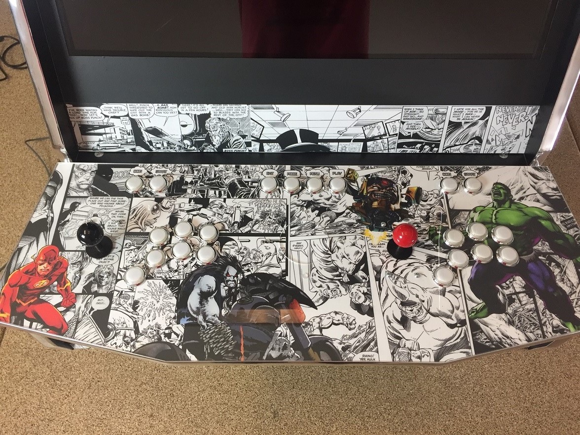

      Hey Guys, starting another build here in the near future. Just submitted the artwork over to Game Room Solutions, so hopefully will be receiving a big box or two in the coming weeks. Figured I would share some pics of the artwork and keep you posted with the build progress.
      So far here are the parts that will be used in the build:
      32" Toshiba LED TV - 32L310U18
      BOSS Audio BRS65 6 1/2" Speakers
      Small Generic Stereo Amplifier
      HDMI Cable
      32" Arcade Cabinet Kit
      Custom Graphics
      Red Zippy Joysticks
      22 White LED Buttons Chrome Trim
      3" Trackball
      Raspberry Pi 3
      LED strip Lights
      Sandisk 200 GB Micro SD Card
      Switch Socket
      Power Cord
      2 Player USB Contoller Adaptor
      Still Debating on Coin Door
