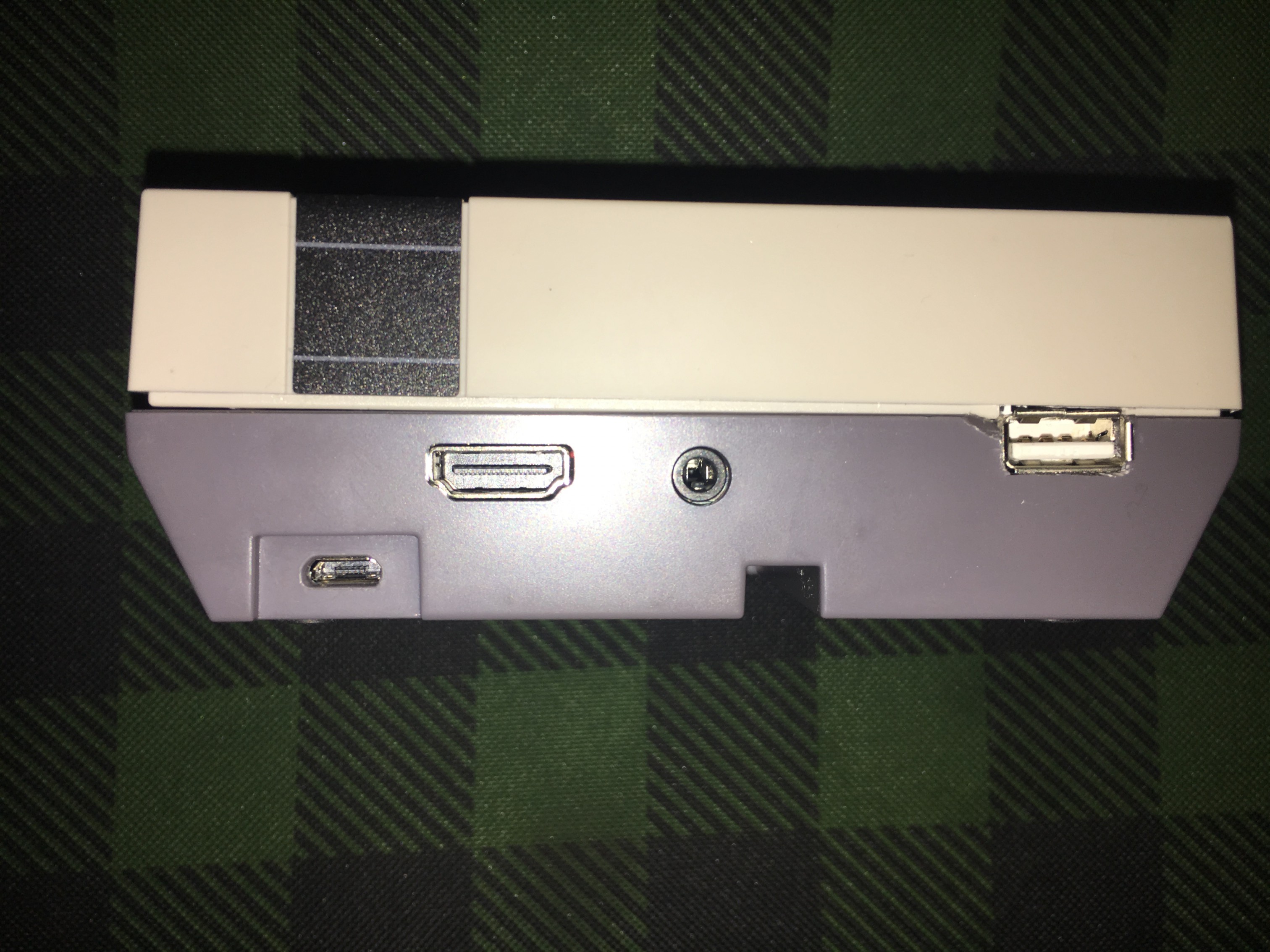

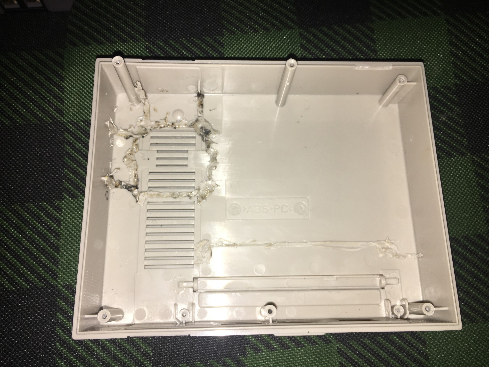

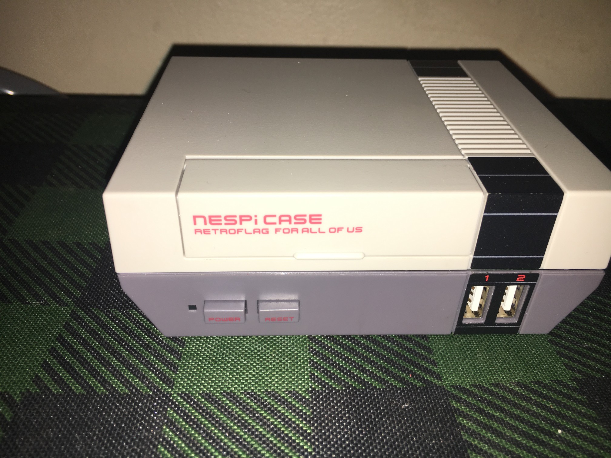

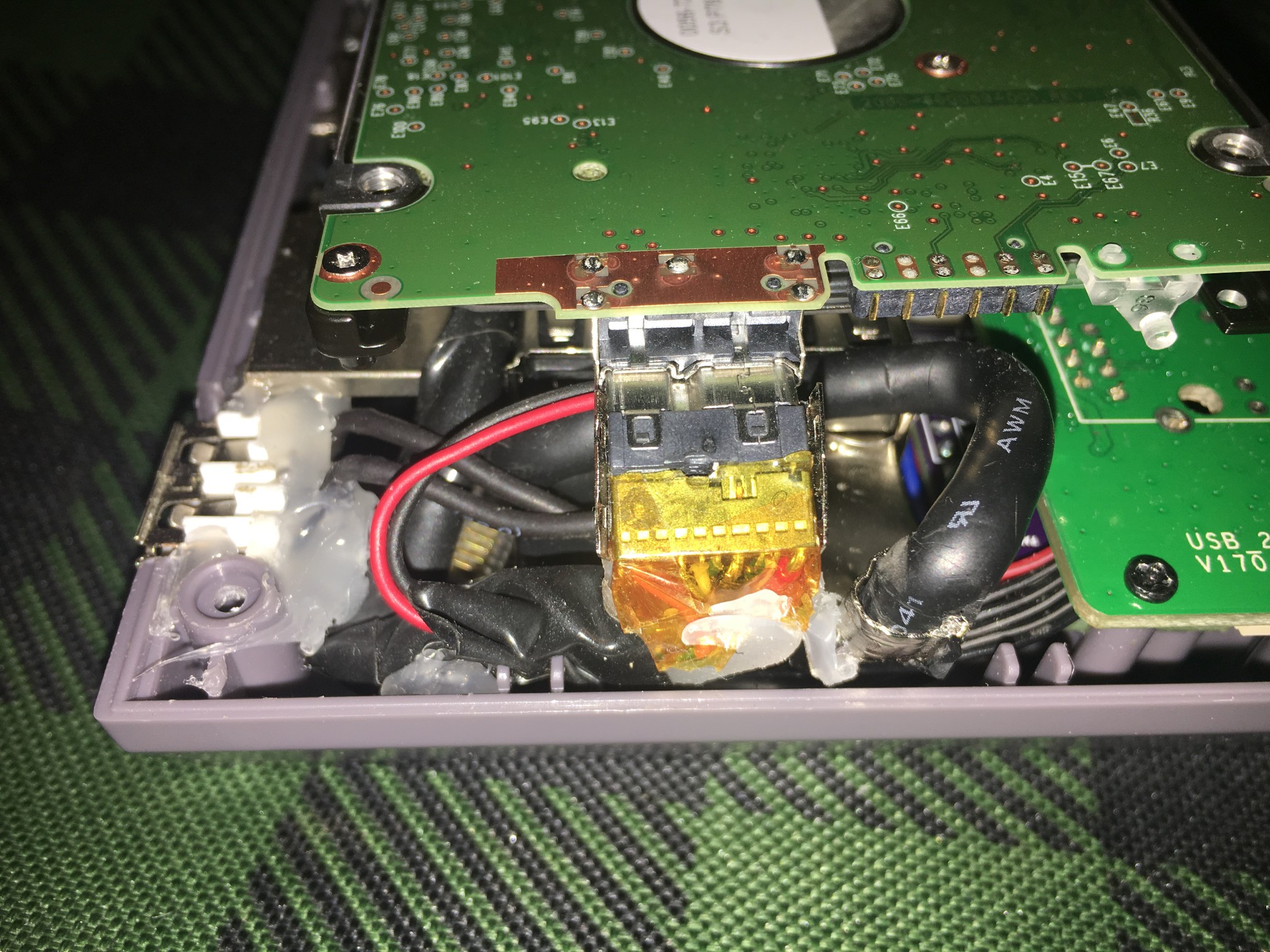

                OK bought everything and built it and it works great. 2tb harddrive would not fit but the 1 tb one does : )
                whats words without pics. so here ya go.
                deleted case ethernet port,case door hinges came out for room, glued closed. had to put dedicated power to the hd to spin right so extra usb port grafted to the drives power wires while data wires go to pie. runs cool enough 50 degrees-ish so far. case closes tighter than pics when screwed together. just took some quick snaps to share. think it turned out pretty good.
