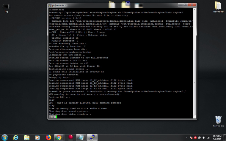

                              dizmodawg
                              @grant2258 said in Dragon's Lair no sound:
                              ls -alh /home/pi/RetroPie/roms/daphne/lair.daphne/
                              Is this what your talking about?
                                grant2258 Banned
