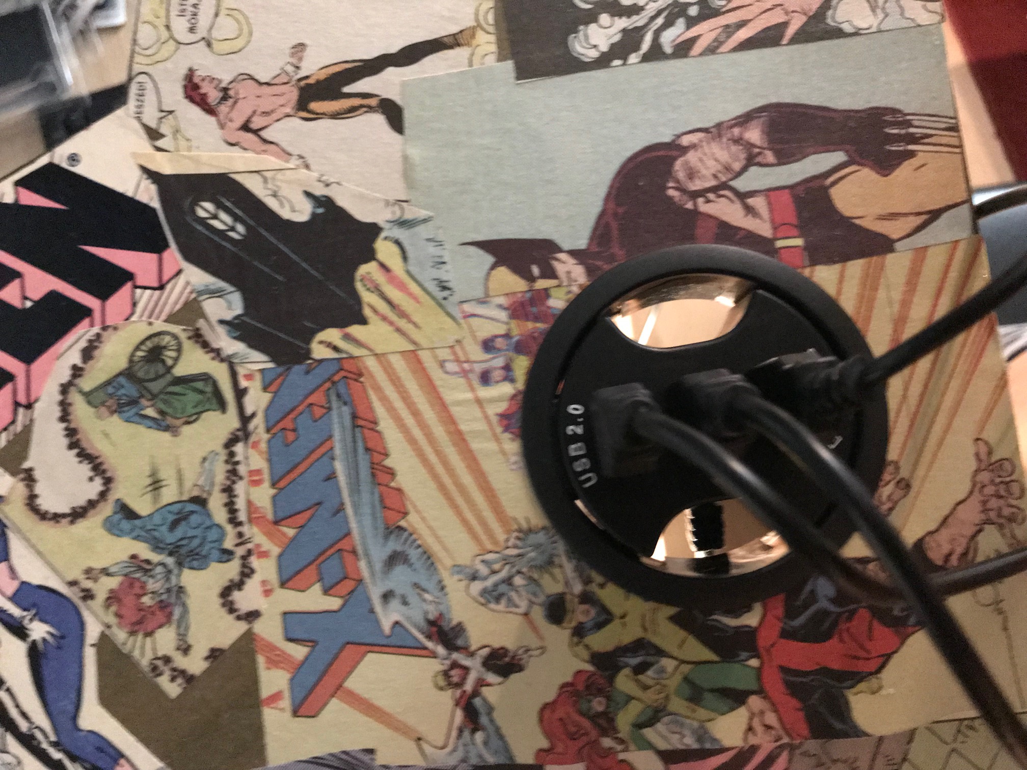

                  Now this is happening that the joysticks are found but despite i am pressing the buttons the label stays grey and it does not let me configure the input. It does not forward me to the configuration screen but it realises that i am pressing the button:(
                  update: i can only configure the usb keyboard. its label is black and it forwards me to the configuration...God i am so f...ked
