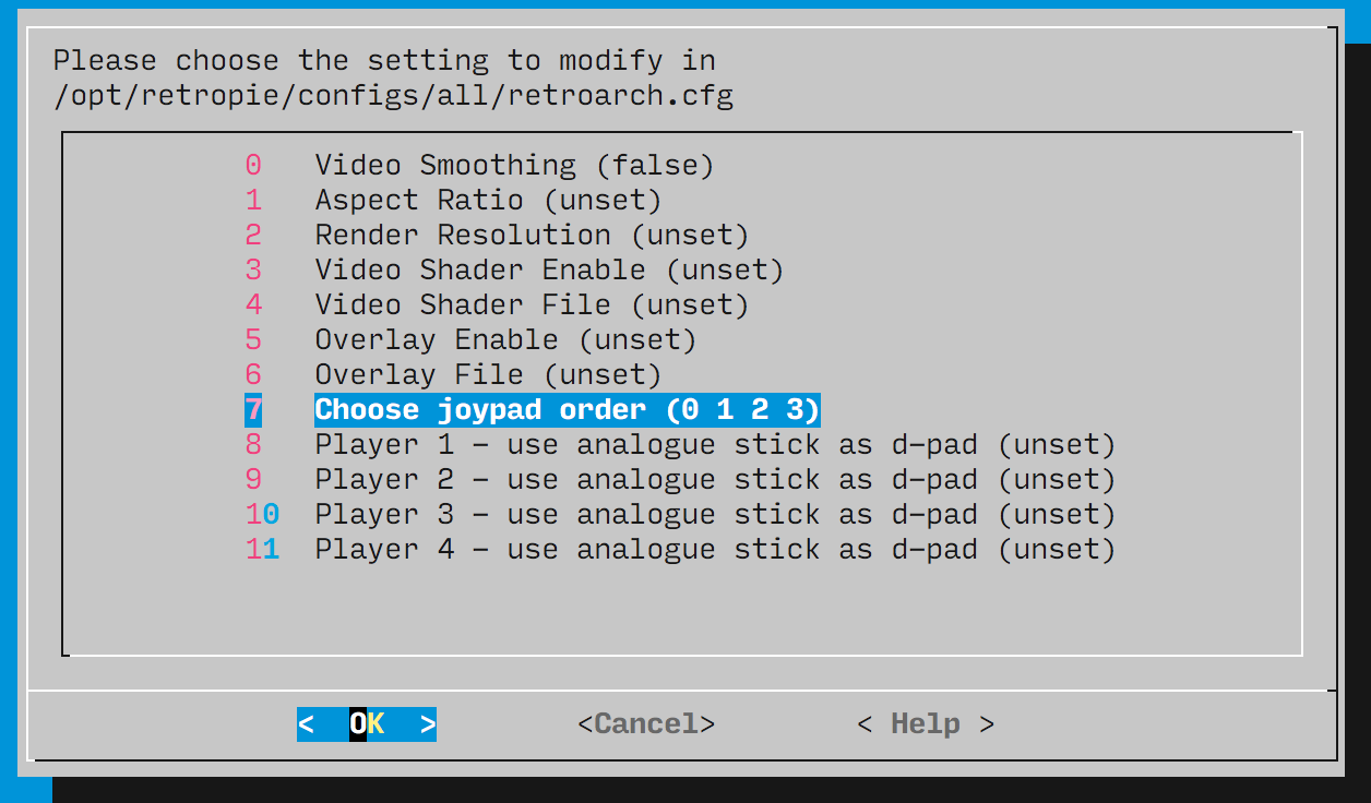

                @aatheronb After getting the logs and posting them on pastebin.com, try the following configuration :
                1. Open the advanced configuration editor - see https://retropie.org.uk/docs/Configuration-Editor/#advanced-configuration - and go to
                  a. 1. Configure basic libretro emulator options
                  b. (next screen) 1. Configure default options for all libretro emulators
                  c. 7. Choose joypad order
                2. In the joypad order screen, each index (1 to 4) will appear as unset. Press enter on each index to assign it the corresponding Xbox controller:
                  a. for index 1, assign controller #0
                  b. for index 2 assign controller #1
                  c. for index 3 assign controller #2 and
                  d. for index 4 assign controller #3.
                  After you do this, click Cancel to go to the previous screen, where the menu entry should read now 7. Choose joypad order (0 1 2 3) (just like in the picture above).
                This setting should make the controller connection order determine also the player number - i.e. 1st controller paired/connected should become P1, 2nd one P2, etc.
