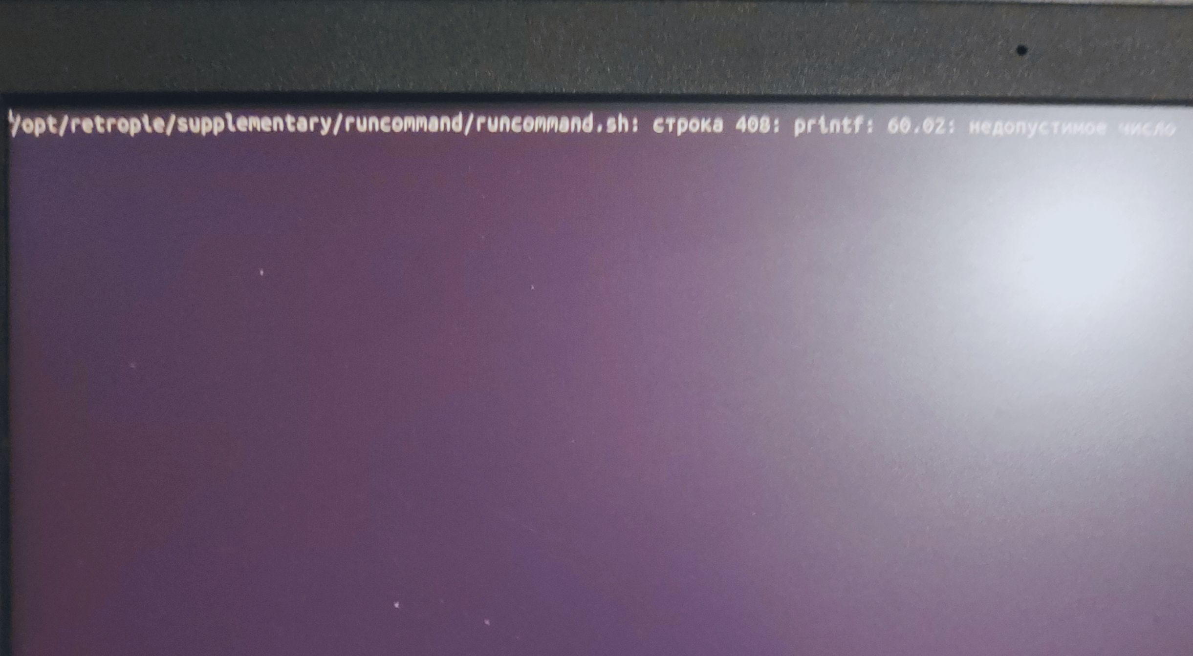

      Hello, I’m a noob on Linux))) after installing retropie on Ubuntu 18.04, an error occurs when starting ROMs: /opt/retropie/supplementary/runcommand/runcommand.sh: line 408: printf: 60.02 invalid number. How to fix it?IMG_20200210_024625.jpg
        Can you add more info about your system - what version of RetroPie are you using ?
        Can you also run - from a terminal/command line - xrandr --verbose and post the output ?

          @mitu Hello, thanks for answering))). Of course I can. Notebook hp pavillion 14, core i5 8520U, nvidia mx130, ram 16gb, Ubuntu 04/18/04. Retropie v. 4.5.1. Installed as written in the instructions. This error opens in a separate window as soon as I start the ROM, then the boot window opens where it says launching ....., press A ...., error are .... and the ROM starts. But if you make a move between the open windows, then it will be there until the game is closed and the retropie menu is exited. And so every time. Does this ```xrandr --verbose

            @mitu performed xrandr --verbose
            sergei@sergei-HP-Pavilion-Laptop-14-ce0xxx:~$ xrandr --verbose

              I think the problem is because the terminal localization is set to something that makes printf to fail:
              pi@retropie $ _number=60.02 && LC_ALL=ru_RU.UTF-8 printf '%.0f\n' ${_number::-2}
              -bash: printf: 60.: invalid number
              0
              # with EN or C locale:
              $ _number=60.02 && LC_ALL=en_GB.UTF-8 printf '%.0f\n' ${_number::-2}
              60
              # _number=60.02 && LC_ALL=C  printf '%.0f\n' ${_number::-2}
              60
              Try modifying the RetroPie start-up link so that it starts with C locale, this should make the problem go away. Open the $HOME/.config/autostart/retropie.desktop and change the line:
              Exec=gnome-terminal --full-screen --hide-menubar -e emulationstation
              to
              Exec=gnome-terminal --full-screen --hide-menubar -e "LC_NUMERIC=C emulationstation"
              See if this solves your issue.

                  pechenbka @mitu
                  @mitu I went under Root, made the changes as indicated.
                    mitu Global Moderator @pechenbka
                    @pechenbka So, did it work ? Do you still have the same issue ?
                      pechenbka @mitu
                      @mitu Unfortunately, this did not work, now when you try to start retropie, a terminal appears with a red line as in the photo above. and it does not start.
                        @pechenbka Seems like instead of starting the EmulationStation front-end, now it opens the file editor ?
                        What happens if you run the command from a terminal:
                        P 2 Replies Last reply Reply Quote 0
                          pechenbka @mitu
                          @mitu ok when I get home from work I will immediately write the results
                            pechenbka @mitu
                            @mitu
                            sergei@retropie:~$ gnome-terminal --full-screen --hide-menubar -e "LC_NUMERIC=C emulationstation"
                            # Параметр «-e» устарел и может быть удалён в будущих версиях gnome-terminal.
                            # Используйте «-- » для указания завершения параметров, а затем укажите строку команды.
                            # Error retrieving accessibility bus address: org.freedesktop.DBus.Error.ServiceUnknown: The name org.a11y.Bus was not provided by any .service files
                            sergei@retropie:~$
                              How about if your start an xterm, make it fullscreen, then run
