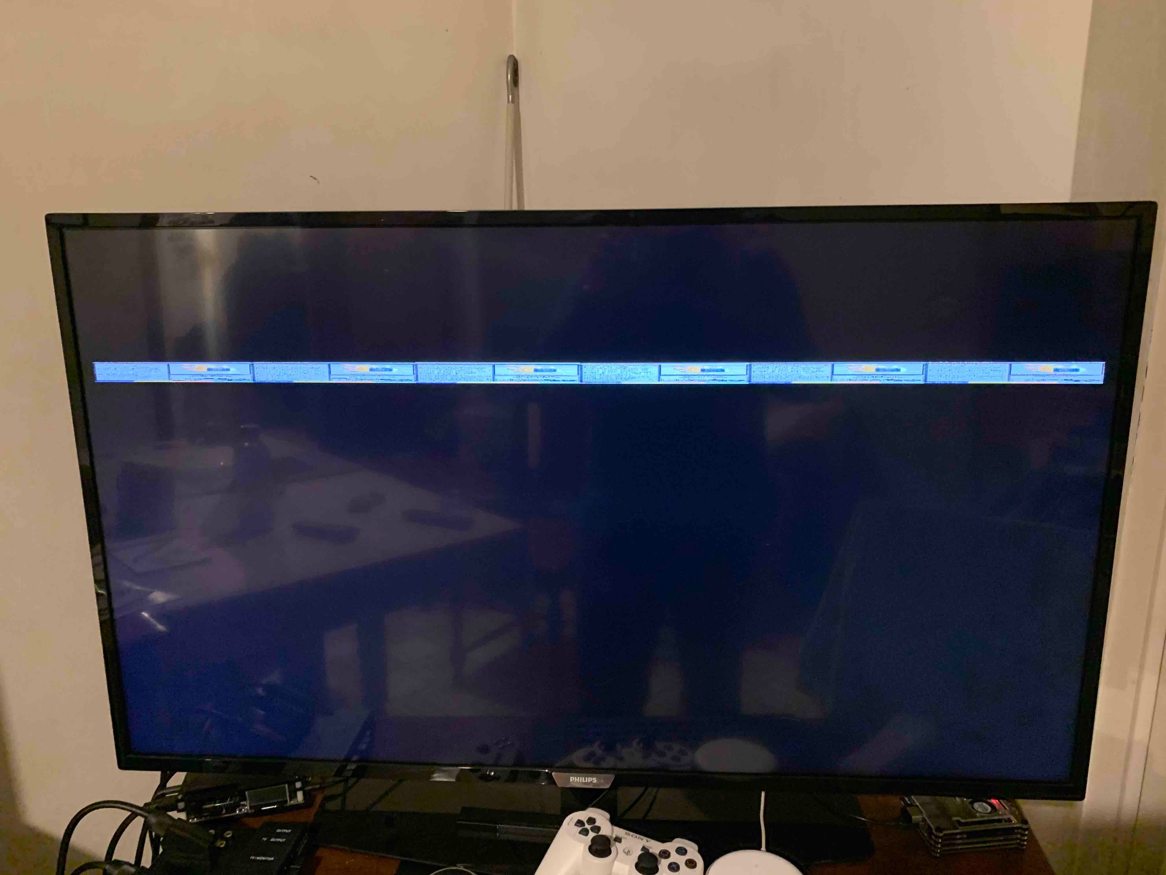

                    @mitu I did try to install OpenBor on my Pi4, but it does not start. I get this screen
                    The /dev/shm/runcommand.log shows this:
                    Parameters:
                    Executing: SDL1_VIDEODRIVER=dispmanx pushd /opt/retropie/ports/openbor; /opt/retropie/ports/openbor/OpenBOR; popd
                    /opt/retropie/ports/openbor ~
                      Trauma
                      @mitu I've got the very same screen and log as @saccublenda
                        That's strange, I get that screen without the dispmanx driver being added to the command line - that was the whole reason it was added. Needs more testing then.
                          Ok, there's should be a fix for this error - update the RetroPie-Setup script and re-install the openbor module, the screen resolution should be fine now.
