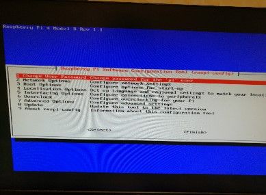

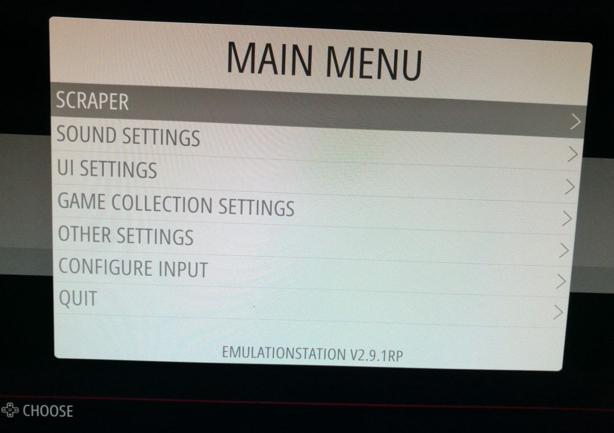

      Hello, I just started learning to use raspberry pie。
      I can't use the setting function. When the option in Figure 1 is turned on, the screen will be black, as shown in Figure 2.
      Normal use of simulator,nes and gba。
      I tried to replace TF card and burn img again, but I still couldn't use the settings.

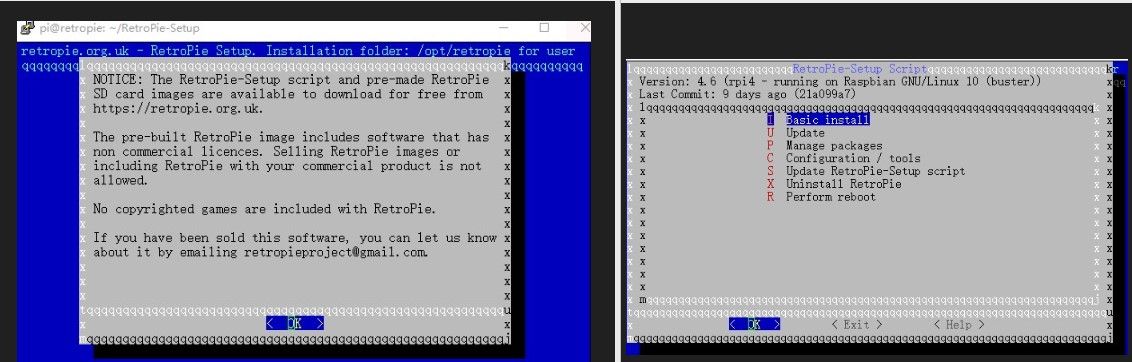

              ksdbgood

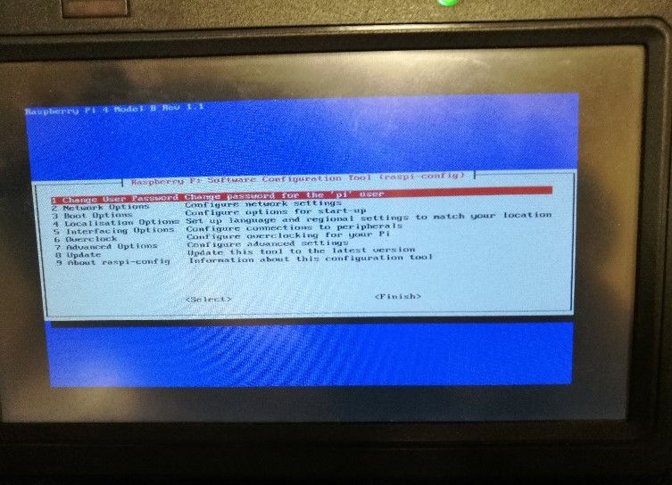

                  Just now I inserted the raspberry pie into a small-sized display for the convenience of code input, and found that it can work normally and the settings can be used normally. Before I plugged it into the sub HDMI interface of my main display, now it can work normally. thank you

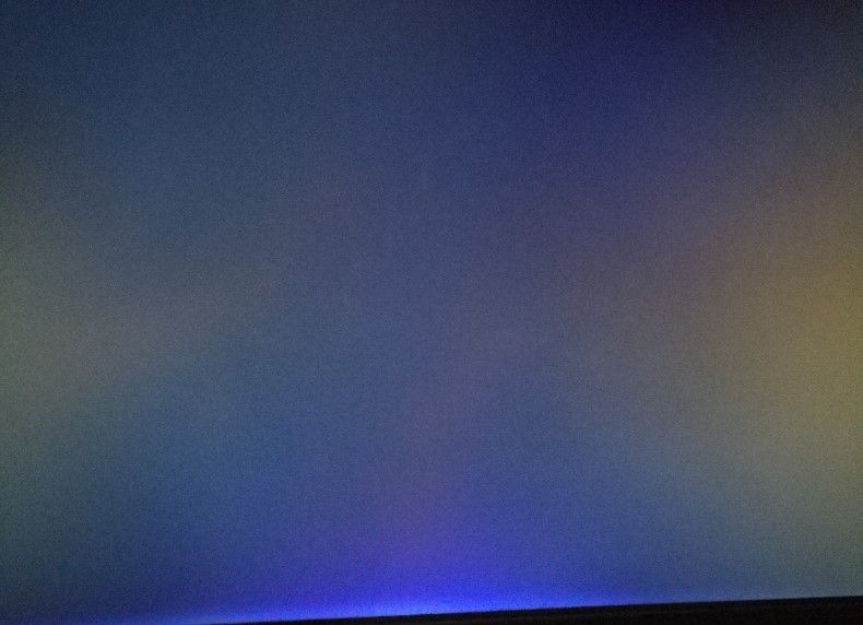

                    It can also display normally when plugged into the main HDMI interface on the large monitor. I may have bought a bad monitor.s7.jpg
                    Finally, thank you for helping me.
