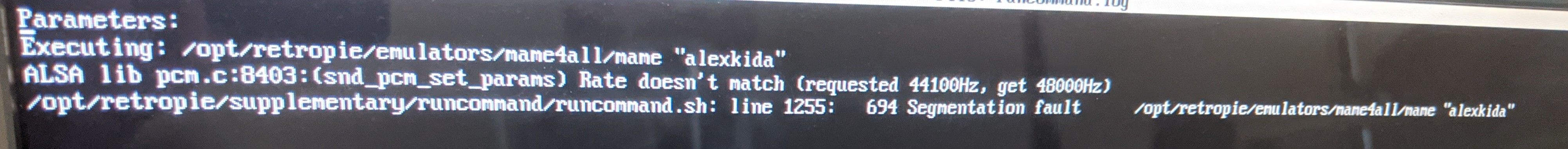

            From what I see, mame4all is picking up only the 1st (default) audio card. Post an emulator log, maybe that would show the error (/dev/shm/runcommand.log).
            T 1 Reply Last reply Reply Quote 0
              t3stin @mitu
              Have tried changing the sample rate to 48000hz in mame.cfg (I assume in the right directories) but still says the same - requested 44100hz etc.

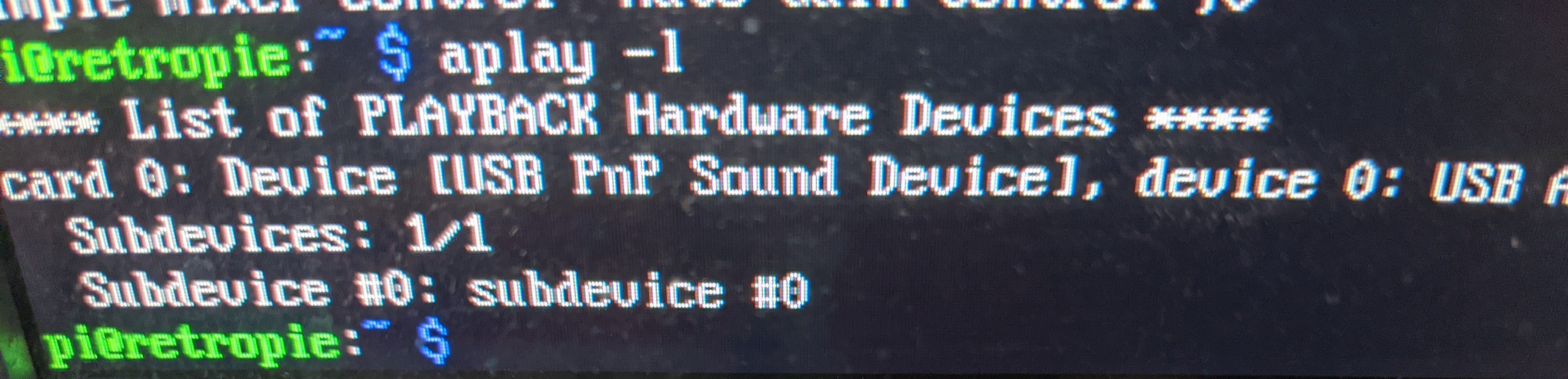

                      @t3stin Try listing the cards with aplay -l, yours may have a different name.
                        t3stin @mitu

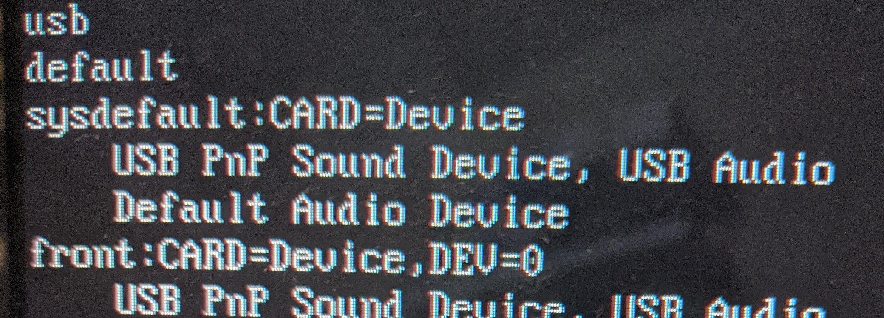

                        @mitu so I get the right answer here's a few screenshots if you're able to decipher? In ES I have card as sysdefault, device as speaker and 0MX as ALSA:HW:0,0
                          t3stin @t3stin

                            t3stin @t3stin
                              Sounds like the name is 'USB PnP Sound Device'.

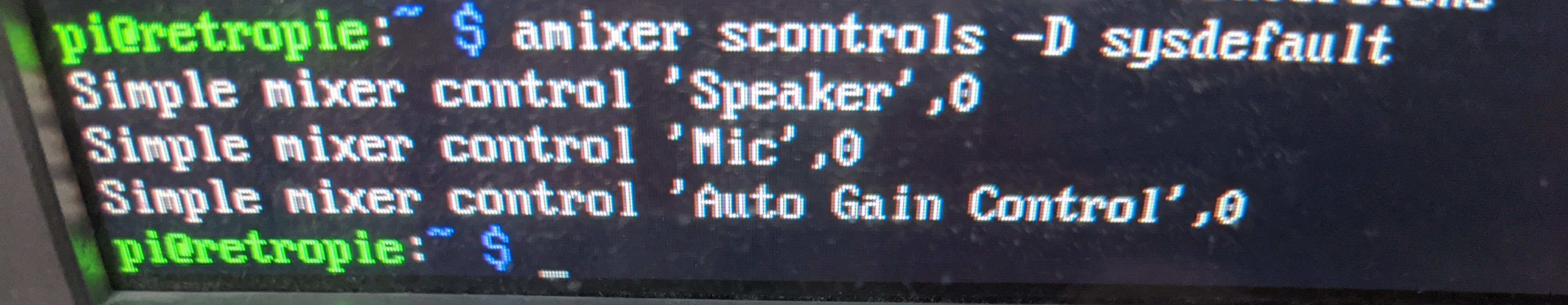

                                  check with alsamixer to see what the volume it set too
                                    t3stin @grant2258
                                    @grant2258 I had checked there, it was set to 100
                                      grant2258 Banned
                                      can you post the output of
                                      amixer -M
                                      and
                                      amixer
                                        t3stin @grant2258
