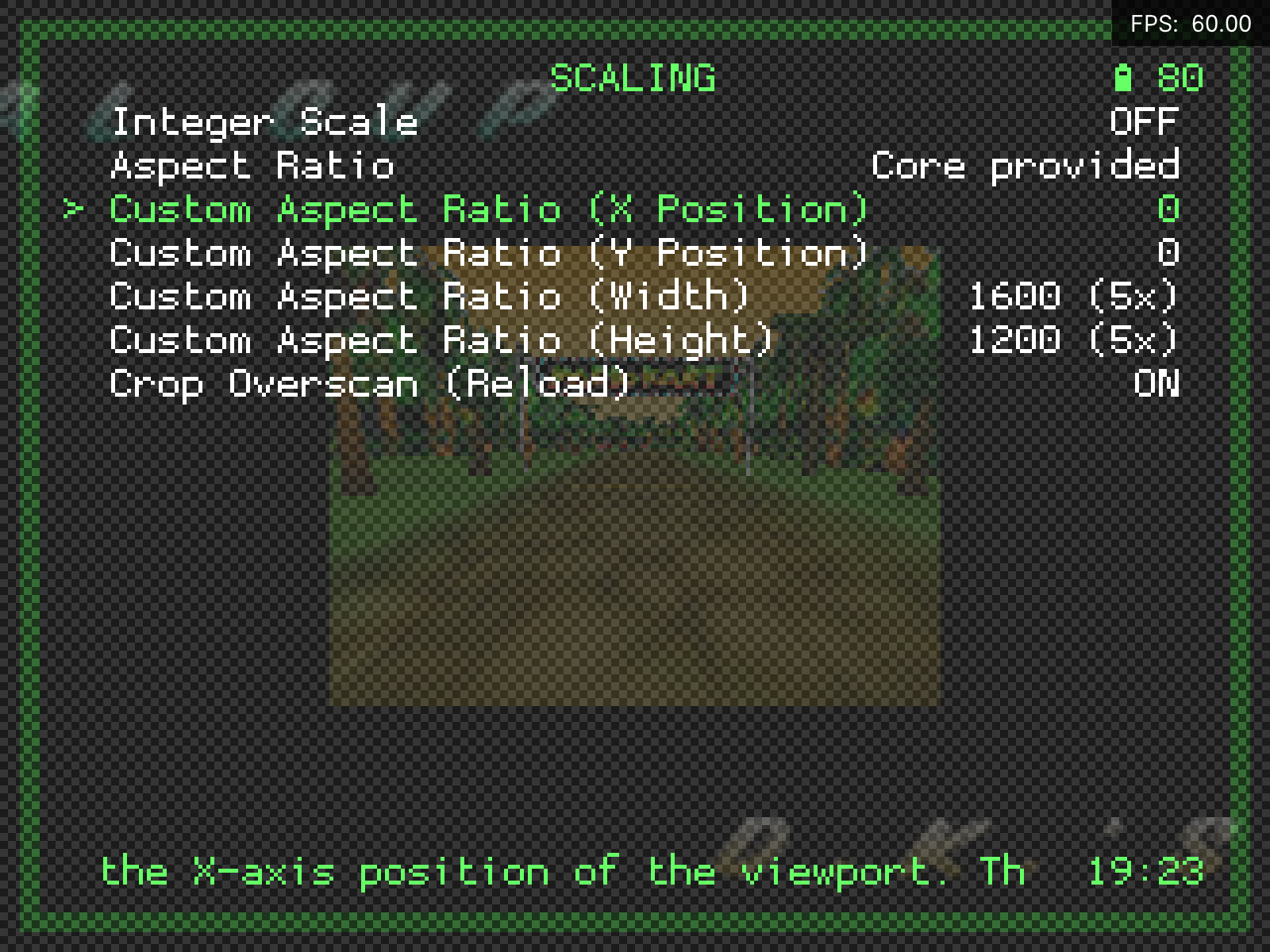

                Assuming you're using the Video Scaling options - what exactly do you have set-up there ? Isn't the video fullscreen (vertically at least) ? This is what it looks like here

                  cnoto @mitu
                  @mitu This was helpful. I think I have solved the issue! Thanks
