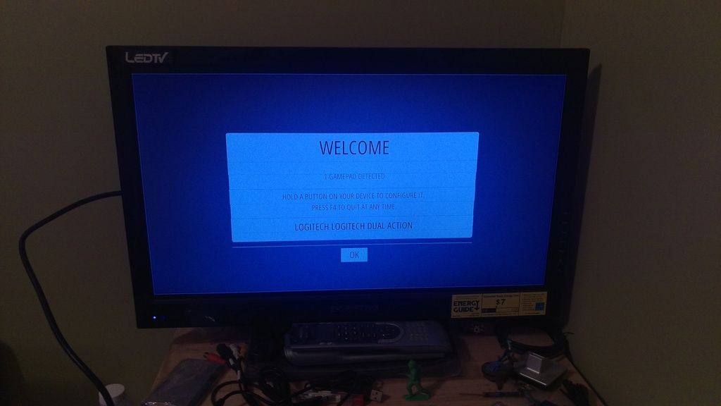

      ON a fresh install of retropie I get to the input setup and if I tap a button on the controller, it registers it. It also sees the kbd that I have plugged in. However, once I press and hold a button to get input configured, it shows, in this case a Logitech dual action. After that, nothing works. I have to SSH into the pi and reboot it.

          Tried it again...it gets as far as the "OK" at the bottom of the screen, but the welcome screen is still there, and the 4th block flickers a bit. Here is a shot of the screen:
          http://i192.photobucket.com/albums/z138/mbafernandez/IMAG0478_zpskhgswjai.jpg
          Once it gets here, it won't take keyboard input or any form of input. I can SSH into it still, and I can run the joystick test without an issue.

            Fixed. Reinstalled and all is well.
