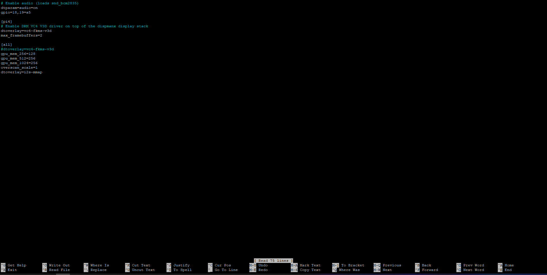

      I have some ohm speakers connected to my raspberry pi zero 2w and when I turn the raspberry on, the audio only works during the retropie intro. When the intro finishes, it automatically connects to the HDMI audio and I have already tried to force the audio jack through the raspi-config/general settings. The audio jack 3.5 mm option doesn't appear, only HDMI.

            Can you post your config.txt ? I suppose you've added the necessary options there to activate the audio.

                @iLouzze I also remembered that my speakers are PWM
                  Make sure you're using either GPIO 12/13 or 18/19 for the audio, then add to your config.txt just
                  dtoverlay=audremap,pins_12_13
                  or
                  dtoverlay=audremap,pins_18_19
                  depending on which GPIO pins you use. Remove any other options that you added.
                  I 1 Reply Last reply Reply Quote 0

                          @mitu ok I already have my speakers working. It was just a code I needed to write below the ```
                          Enable audio (loads snd_bcm2835)
                          • I
                            iLouzze @iLouzze
                            @iLouzze ```
                            gpio=18.19=a5
