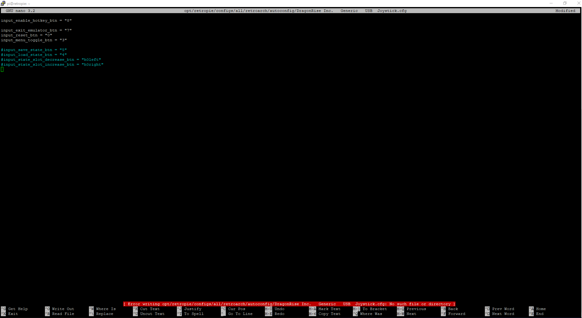

                  @sleve_mcdichael said in HELP I want to disable the hotkey + (X) setting:
                  nano "opt/retropie/configs/all/retroarch/autoconfig/DragonRise Inc. Generic USB Joystick.cfg"
                  ok, I'm in but it says that there's no directory
                  I already tried to write on it the thing below:
                  input_enable_hotkey_btn = "8"
                  input_exit_emulator_btn = "7"
                  input_reset_btn = "0"
                  input_menu_toggle_btn = "3"
                  #input_save_state_btn = "5"
                  #input_load_state_btn = "4"
                  #input_state_slot_decrease_btn = "h0left"
                  #input_state_slot_increase_btn = "h0right"

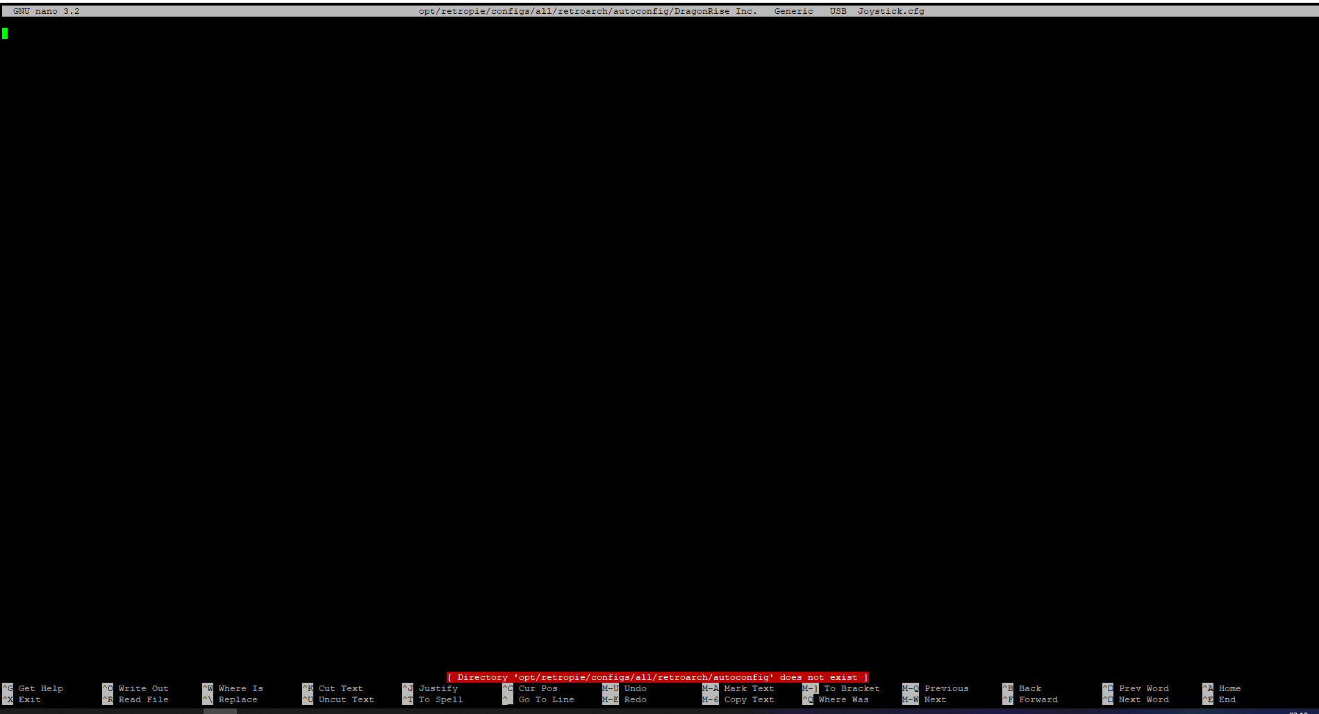

                  but when I click on save then it tells me this:
                    sleve_mcdichael @iLouzze
                    @iLouzze that's my bad, I missed the slash (/) before "opt". It should be:
                    nano "/opt/retropie/configs/all/retroarch/autoconfig/DragonRise Inc.   Generic   USB  Joystick.cfg"
                    I 1 Reply Last reply Reply Quote 0

                      @sleve_mcdichael does it must appear a black screen after I enter the code?
                      because when I access this happens:
                      I copied the code you wrote before on the black screen and added the hashtags before the functions that I didn't wanted, but they were still working when I tested them with the hotkey.
                        @iLouzze it shouldn't be blank, I would expect there to be some definitions in it already from the auto-configuration. Maybe that's not the right file name? Can you list the directory contents with:
                        ls -l /opt/retropie/configs/all/retroarch/autoconfig
                        ...and post the output?
