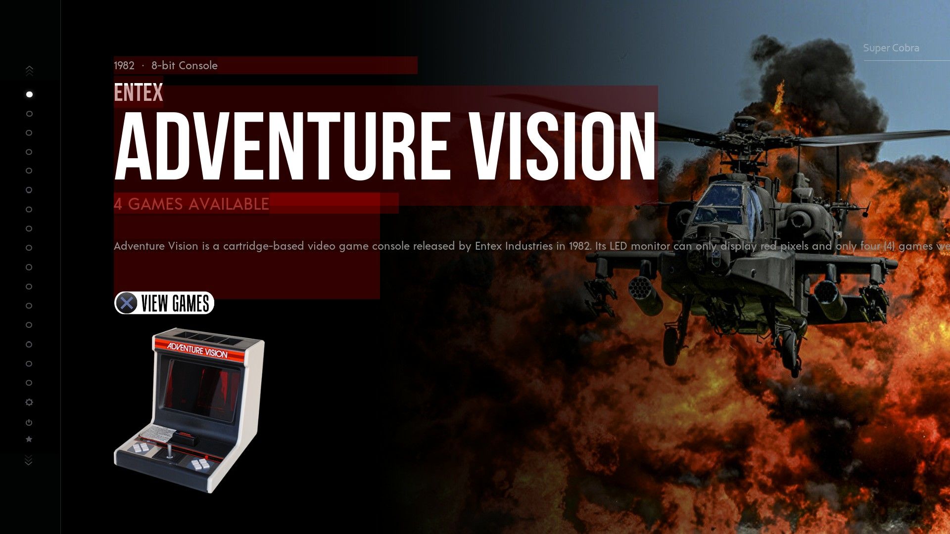

      Prior to submitting a git issue for RetroPie/EmulationStation master, I am posting here to verify a recent change in behavior with EmulationStation-Dev. In short, for themes, long-descriptions no longer wrap. It appears that they're no longer respecting the size of the bounding box.
      Hope this is helpful.
      Comparison images posted below:
      Standard EmulationStation (correct wrapping):
      EmulationStation-Dev (incorrect wrapping):

              @roslof can you please redo your screenshots from ES (Stable and Devel) when running emulationstation --debug and then pressing left-Ctrl+ t (emulationstation --help will also outline the commands) to make the bounding box visible as it is defined in the theme and interpreted by the ES layout engine? This would help to narrow down the cause. Thx.
                No trouble.
                ES-Stable:
                ES-Dev:

                    Sorry pals to void your assumptions. The theme text components do not play by the book [1]. If you set the y-size of the longdescription to 0 the text wraps correctly. This also reveals then the misplacement of the longdescription. You can see it also above in the screnshots: The red boxes of "Games available" and the box for the longdescription overlap. A y-value of 0.410 instead of 0.360 for the position remediates this.
                    Like this (theme.xml in es-theme-epicnoir/):
                        <text name="longdescription" extra="true">
                            <fontPath>./_art/Acre.otf</fontPath>
                            <alignment>left</alignment>
                            <forceUppercase>0</forceUppercase>
                            <fontSize>0.02</fontSize>
                            <color>8F8F8F</color>
                            <lineSpacing>1.18</lineSpacing>
                            <origin>0 0</origin>
                            <!--pos>0.12 0.360</pos-->
                            <pos>0.12 0.410</pos>
                            <!--size>0.28 0.20</size-->
                            <size>0.28 0</size>
                        </text>
                    And by the way it was the removal of this line [2] in commit e44e0b7 which corrected the loophole, but unfortunately other themes may also be affected, thus I guess it would be reasonable to enable backward-compability to those themes.

                        At this point, I can only spot one last visual delta as it relates to wrapping. In the image below, the word "Manager." at the end of the long description used to live on the previous line. The vertical growth causes the overlap to be visible (again, theme issue, but a noteworthy delta).
