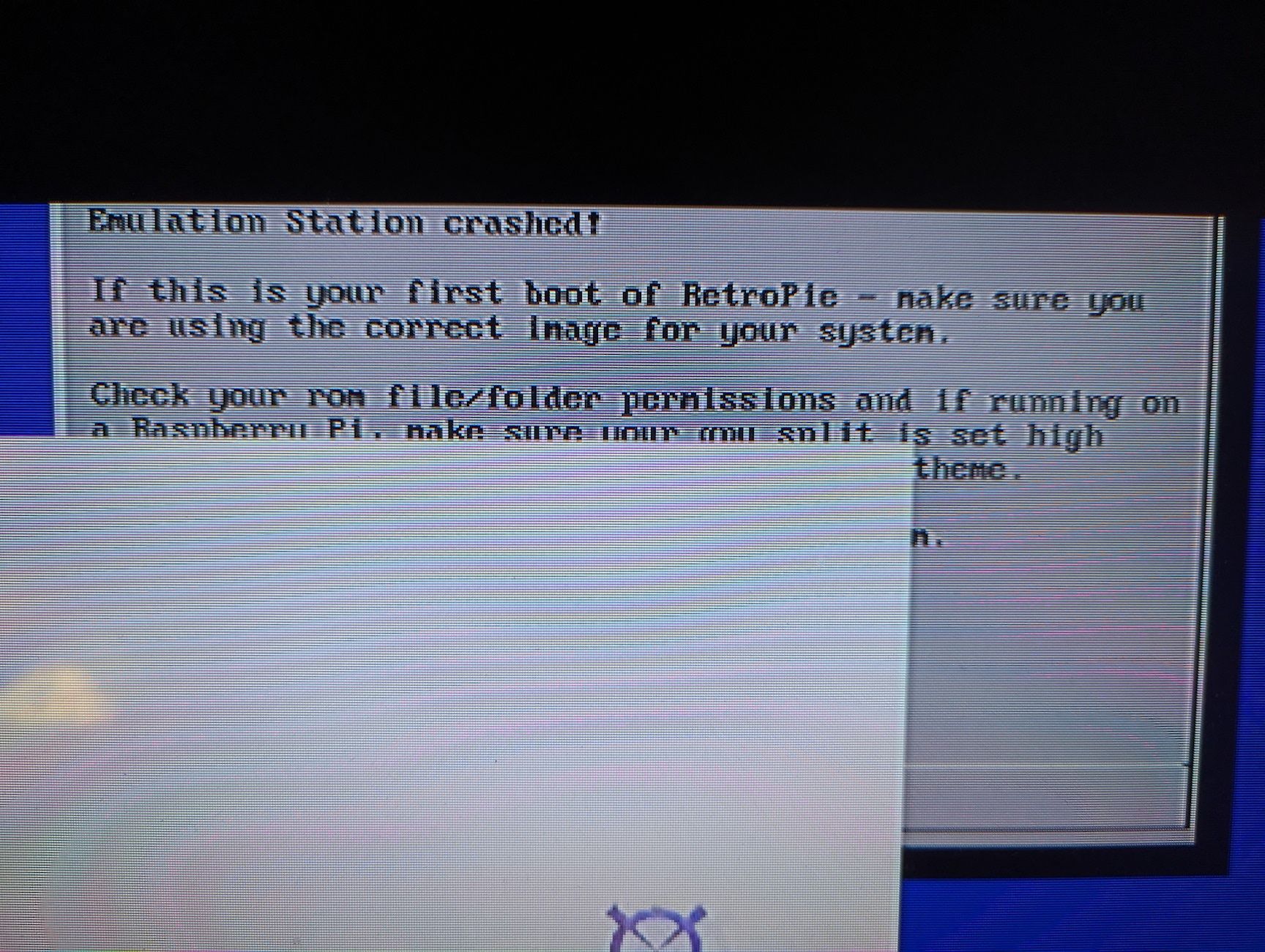

      I was removing games from a custom collection (sorting light gun games for a Dolphin bar) when a text box appeared behind a game video preview. The preview was blocking the text, I couldn't read the message and there was no way to navigate out so I had to power down. This happened again after reboot. I decided to just proceed with transferring roms over the network per usual, but my computer could not connect to the Pi. I checked Show IP and received the message in the image. I tried to reconnect to the wifi network previously used, but it will not connect. Please help! If I connect to an ethernet, will that restore the IP address to transfer over the network? I'd of course prefer to solve the wifi issue. Thanks for any guidance!
        djdq13 @djdq13
        @djdq13 Here is the message that appeared behind the video preview. I can see what happened now. Where do I go from here to restore wifi and the IP address? And what else should I check for that might be damaged? Thanks!

            @windg No luck. Unable to connect. If I can connect with the Ethernet and that restores my pi's ip so I can transfer over the network, I'm fine with it. I'm thinking the crash and loss of Wi-Fi connectivity are somehow related. Every other device is connected with signals per usual on the wifi and there was no issue until after the crash occured
