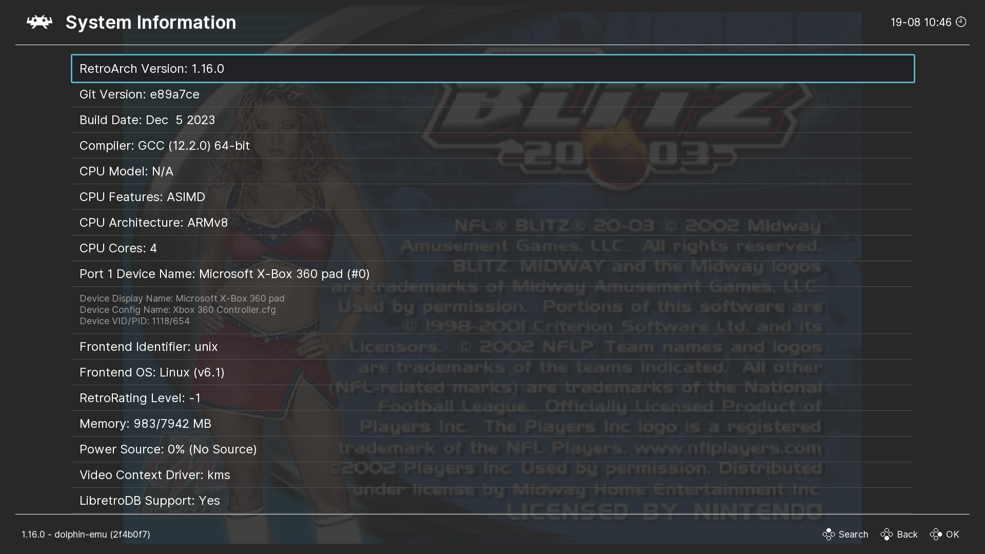

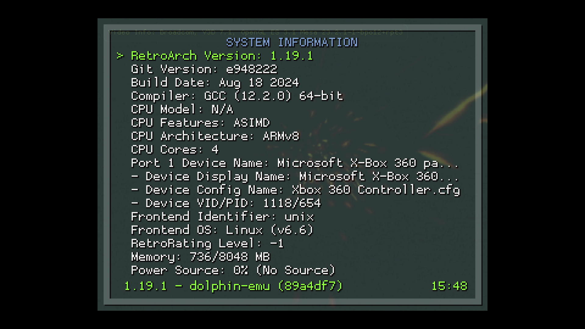

          @mitu So further testing...
          This build I had downloaded a few months ago, I can load up NFL Blitz 2003 (USA).rvz 25 times in a row and it doesn't crash.
          With the vanilla new install of RetroPie I made yesterday, it crashes on the loading screens 1 in 5 times.
          Here's the info from the other build
          Here's the info from the build I made yesterday:

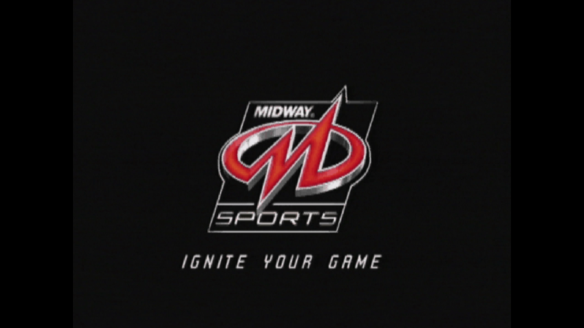

          And it usually crashes here:
          or here:
          If it makes it past these screens, I can play the game for a good 10-15 minutes without any issues. So the crashes seem to be happening right at the start when the game is loading.

          Different versions of RA from the old to the new build, but the lr-dolphin cores have the same file size. Any ideas?
