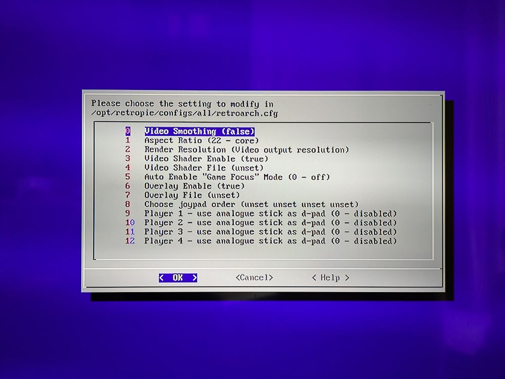

              This is my config on "all libreto":

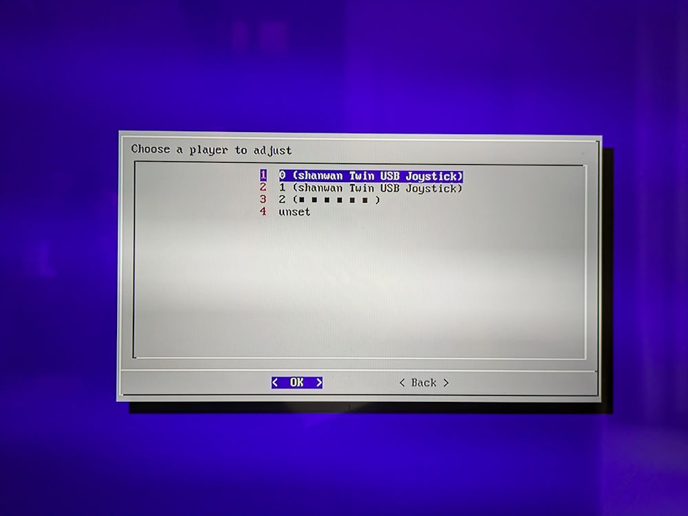

              And this is my config for neogeo:
              NOTE: the Xioami controller on the menu appears as a series of squares I think it is due to the fact that they are Chinese characters.
              With this configuration if I turn on only the arcade controller it works on RetroPie but it doesn't work on games (the key mapping seems completely wrong and I can't do anything, not even enter the RetroArch menu), if instead I turn on both the Xioami controller and The Arcade one both work on RetroPie and also games but the Xioami controller as Player 1 and the Arcade controller as Player 2.
                If the contoller works in RetroPie but doesn't in game, then I think the arcade board has incorrectly wired P2 to the controls and P1, which is port controlling the RetroArch menu and the emulator start, is not wired.
                Try using the keyboard (F1) to open and navigate the RetroArch menu and re-order the ports on the controller so that P2 becomes P1. In the quick menu that opens up when you press F1, go to Controls, then go to Port 1 and change the device to the 'other' shanwan twin... device. See if you can control the menu with the arcade board now and if you can start the game. If that works, save a remap and see if it's permanent by restarting RetroArch.
