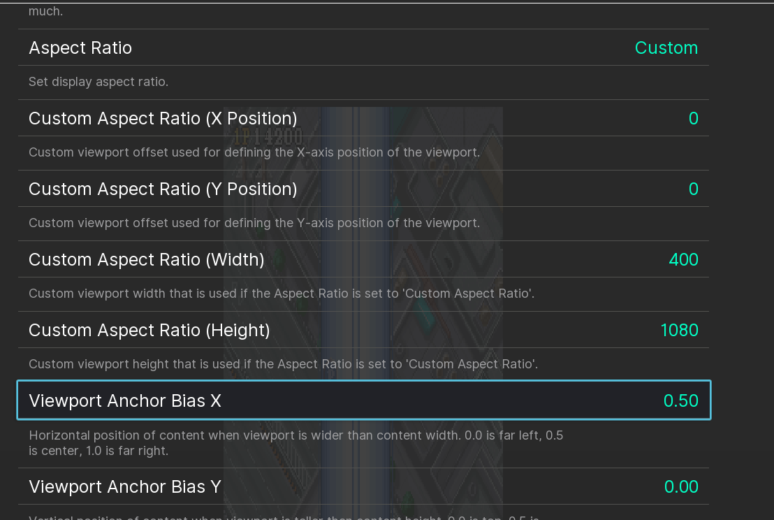

                  Worked perfectly, thank you. I would like to avoid an off topic post, but I found that some new RetroArch functionality (Viewport Anchor Bias X/Y) caused immediate issues with custom scaling. If desired, I can perform a moderate sweep of 1.21.0 and report any issues in a separate topic, or offline somewhere.
                    You can report the issues to RetroArch directly, but make sure you start with a 'stock' config and not with any RetroPie configuration. This feature has a regression with the RGUI display - see my comment in the PR - and I wish I've caught that sooner.

                      @mitu I reported an issue regarding incorrect screen positioning with gl and glcore when the aspect ratio is set to custom. A common use case would be somebody using overlays with a custom bezel that's using those video drivers. Vulkan and SDL2 work fine...
                      The screen is shifted vertically in every scenario with any core. The issue occurs with RetroArch 1.20.0 up to current and it's definitely related to the inclusion of Aspect Bias X/Y functionality. The default values (each at 0.5) try to put the game in the center of the screen. Overriding each to 0,0 allows custom settings to map to pre 1.20.0 values. Bias Y is jacked...
                      Although I already reported the issue, In wondering if you too could replicate this. I created a simple video that demonstrates the problem.
                      Since this only occurs with gl and glcore, wondering if there's a way to update these video drivers in case there are fixes that prevent this issue -- or if the issue is wholly with RetroArch's binary.
                      For games that break, a workaround is to set Bias Y to 1 which isn't ideal, hacking around a bug.

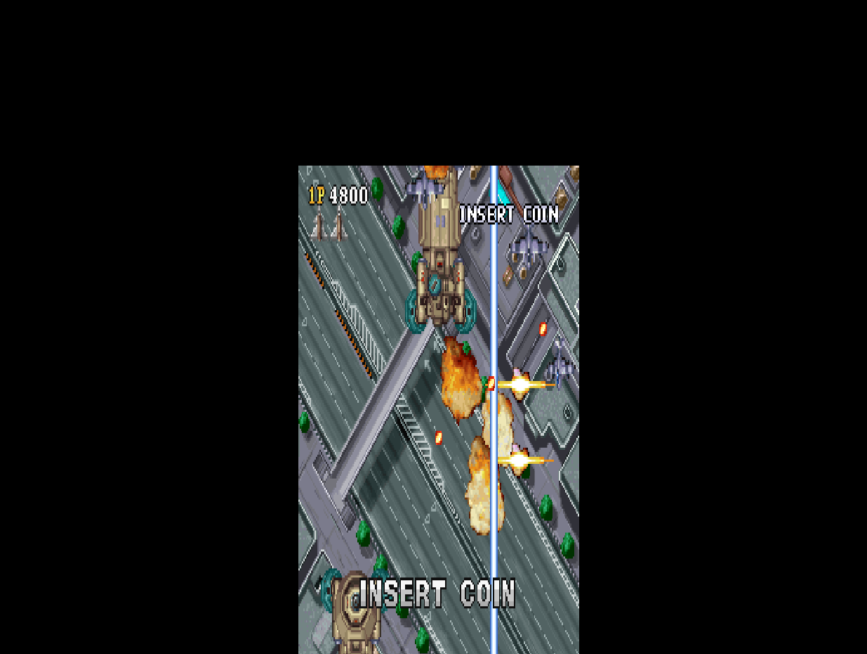

                            @roslof I tried to reproduce the issue and I'm more confused of how it's supposed to look. System used is Windows x64 and FBNeo/RetroArch 1.21, with gl here.
                            I've set a custom AR for a vertical game and viewport size to 400x1080. Even with Viewport Anchor BIAS Y set to 0.0, the game viewable area is pushed down and cut at the bottom. I expected 0.0 to make the game viewable area to be hugging the top size. I'm expecting the X/Y positions for the Custom AR to be anchored top left, so 0 vertical bias should fuse the image to the screen top.
                            roslofR 1 Reply Last reply Reply Quote 0
                              That's exactly the issue I reported. Switch to Vulkan and it will appear as you'd expect. The Y position is only wrong when using gl or glcore.
                              Play with Bias Y and watch the viewable area in the background. You should see that one single frame where it appears where you'd expect before it pops into the incorrect position.
                              ADDING: I searched online for others having the problem. They are. Most are using GL and are advising others to set Bias Y to 1. This "looks" correct, but is a terrible workaround for a fairly obvious bug, especially for those who mix render modes.
