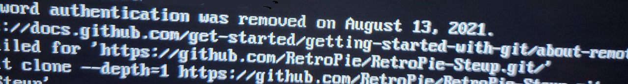

      The manual installation is broken, or hit a weird roadblock
      I am at
      Download the latest RetroPie setup script with
      cd
      git clone --depth=1 https://github.com/RetroPie/RetroPie-Setup.git
      It has me log into github, but has an authentication failure
      Remote: Support for password authentication was removed on August 13, 2021
      So, what do I do?

                          @Jiryn said in Manual Installation Broken at GitHub level:
                          The issue was caused by your typo for the repository URL. Instead of RetroPie-Setup you entered RetroPie-Steup and Github assumed is a private repository and tried to authenticate you.
