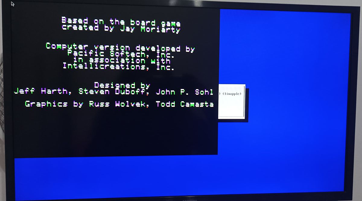

      Hello,
      After updating my Pi 3, I started to make a new image for my new Pi 5 :)
      I sorted some troubles with Retropie 4.8.9 image that someone put on Google Drive (at this forum), but there is one that I couldnt find yet a solution, with Linapple I got a small screen portion when run it, tried with F6 for fullscreen, but doesnt work, any ideas?
      Thanks!

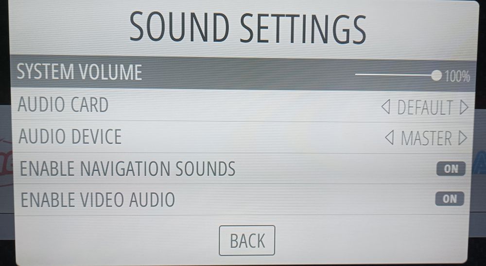

                  I had success with lr-applewin (even without the PR) with an out-of-the-box RaspiOS Lite config.txt, i.e. dtparam=audio=on
                  @pindapoe what yields apt list --installed | grep ^alsa? I have alsa-utils installed. In turn this query should give no hits: apt list --installed | grep ^pulseaudio
                  P 1 Reply Last reply Reply Quote 1
                    pindapoe @Lolonois
                    @Lolonois Tried apt list --installed | grep ^alsa but gave me a "command not found" error
                    I had to configure Audio Device to that way to make it work in Pi 5, maybe that is the problem with linapple?
