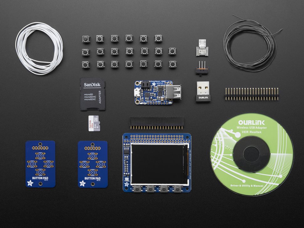

      Now I'm sure most of you are aware of the the Pi GRRL Zero from Adafruit.
      I like the look of this little kit. gives me pretty much everything I needs.

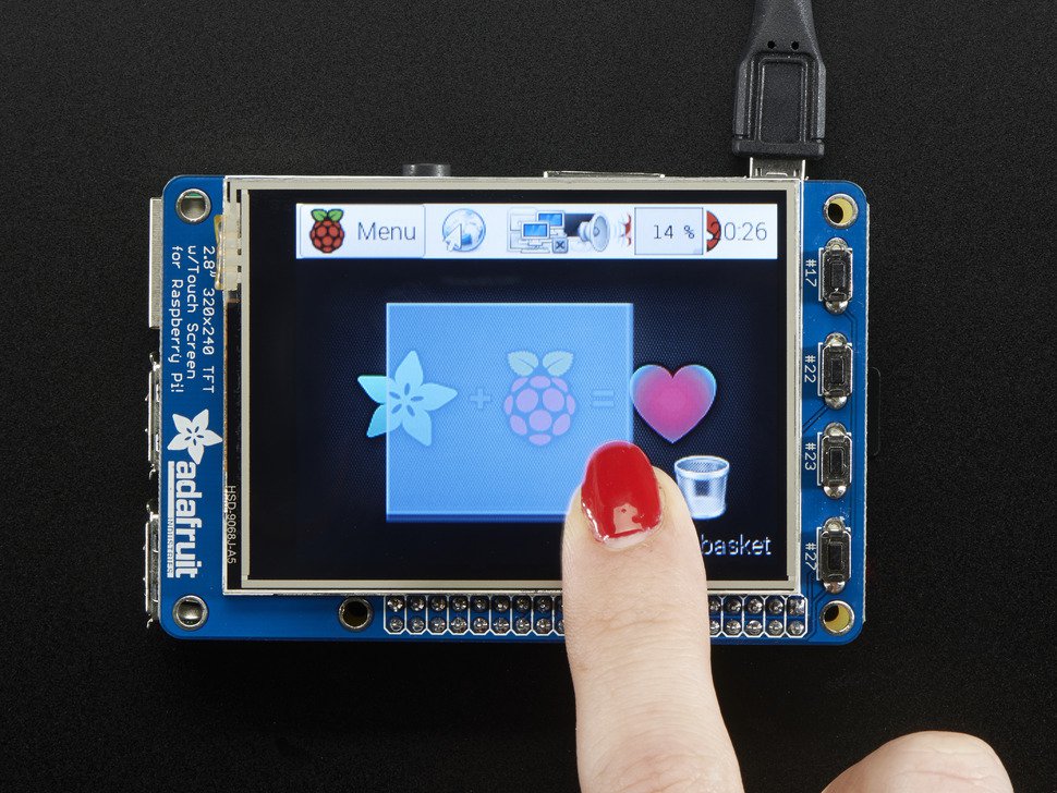

      But theres the kicker. I'm not gonna be using that screen as its too small and instead will be using there 2.8inch version.
      Which also has those tasty little tactile buttons on the side there. Which could be fun.
      So. The biggest issue I might find is getting all these parts to work together. Are Adafruit components known to have any issues with them running with Retropie?

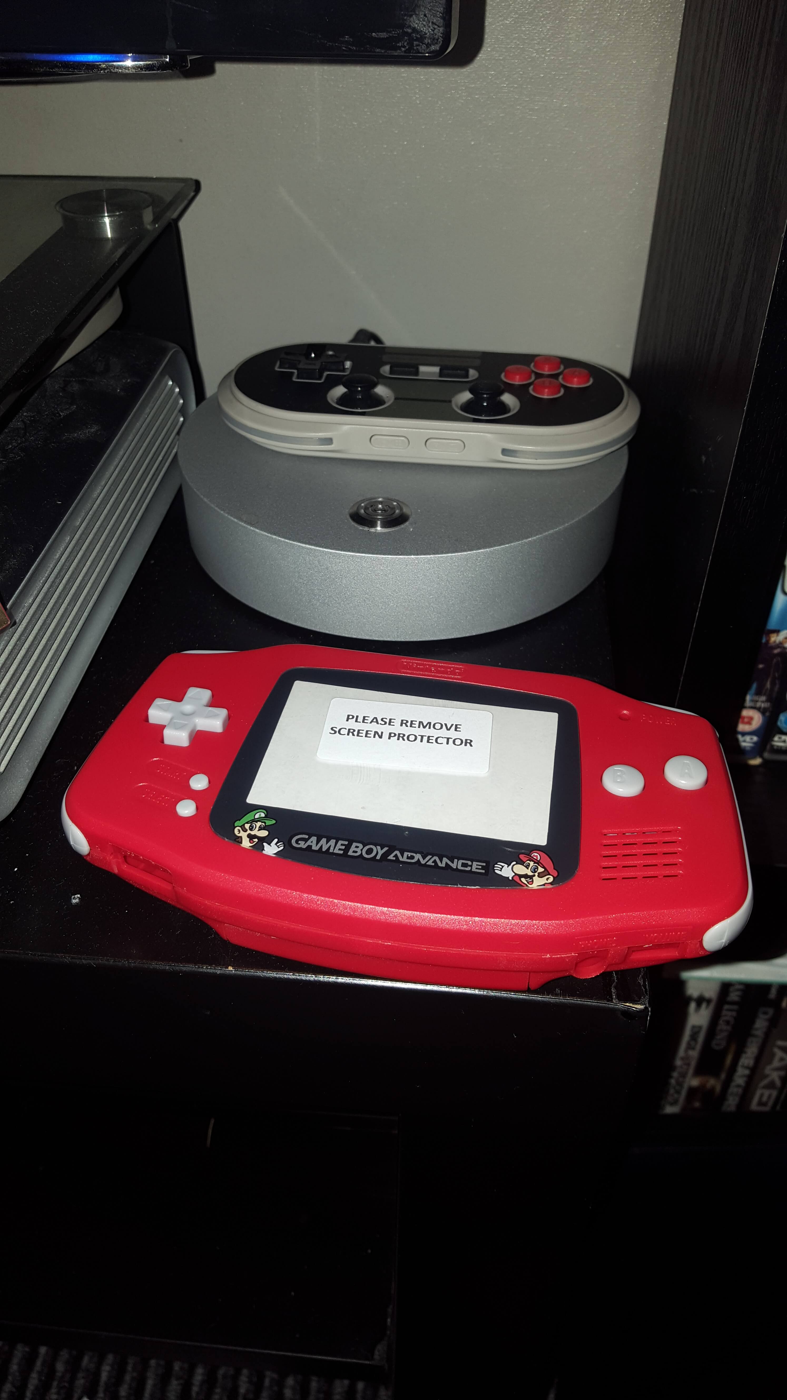

      I'm fairly confident with this build and I've found a beautiful little GBA shell from www.rosecoloredgaming.com. I'll be ordering parts tomorrow. Like he Pi Zero the, the GBA shell and such but otherwise I'll be waiting :)
