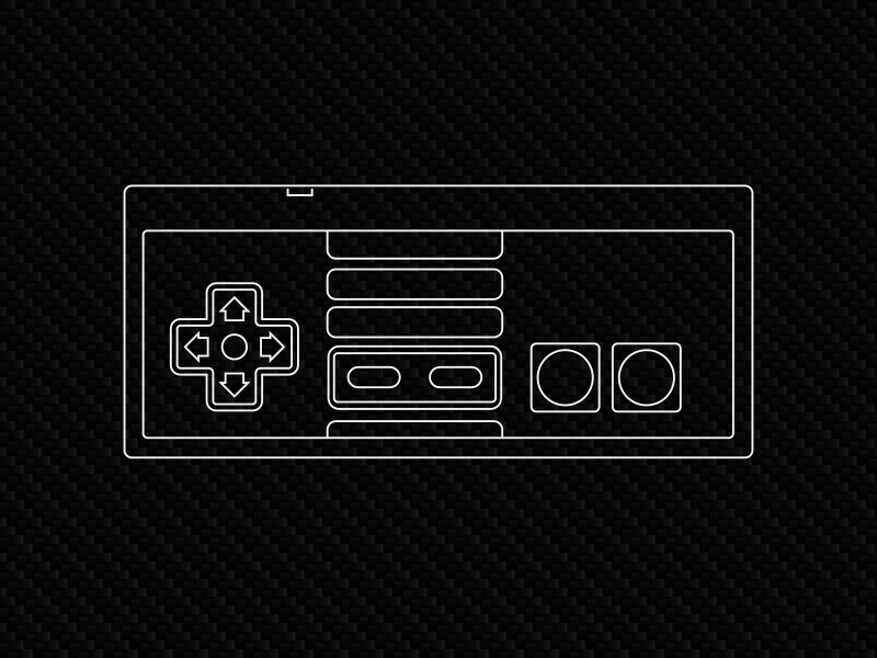

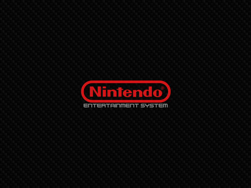

                              By the way, here are some examples of what I could get with my initial research on ImageMagick commands and the respective command line (these commands were executed after the conversion from SVG to PNG):
                              convert -size 800x600 tile:$HOME/tmp/carbon/art/carbon_fiber.png -gravity center ~/tmp/carbon/nes/art/controller.png -composite nes.png
                              convert -size 800x600 tile:$HOME/tmp/carbon/art/carbon_fiber.png -gravity center ~/tmp/carbon/nes/art/system.png -composite nes2.png
                              convert -size 800x600 tile:$HOME/tmp/carbon/art/carbon_fiber.png -gravity center ~/tmp/carbon/nes/art/system2.png -composite nes3.png
                              herb_fargusH RookervikR daeksD 3 Replies Last reply Reply Quote 1

                                Personally I think the run command launch images should have the carbon background instead of just black ;)

                                  @meleu Those look slick already. And use the carbon fiber. Just need some nice text saying to press X or 'any key' to configure run command.
                                  PS, it does seem "X" is the most-correct button to press if you need to get into the run command editor. Any other button seems to be ignored (on a joystick)
                                  Might want to test 1080p versions of these and see how long it takes to load them. I fear it might take long enough to load them that they might just flash on the screen for a split second before the game launches.

                                    @meleu wow, I already love your third image :) I am happy to see that there will be something for carbon as well in the near future.

                                      meleu @herb_fargus
                                      @herb_fargus
                                      But it's already carbon. Maybe are not seeing because you're on mobile?
                                      @Rookervik
                                      Could you make an image with the text with a transparent background (just like the controller lines)? You can choose a font that pleases you...
                                      With this I can make the launching images for carbon...
                                      Actually runcommand gets input from the 0 and 1, and unfortunately the manufacturers don't have a standardization about these numbers. I have several joysticks here and the <ENTER> button (button 0) differs in all of them.
                                      The "a" on the text should be an indefinite article, not the A button of the joystick. :-)
