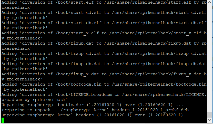

      Hi everybody!
      I was upgrading my raspberrypi (3), but it's stuck at "Unpacking raspberry-kernel.headers..." for almost 30 minutes now.
      Is it normal? Please tell me that everything is not lost and I don't have to fresh install again :)
      Thanks
        meleu @sonostrano
        @sonostrano I'm not sure what happened, but you can hit ctrl+c and cancel the updating process.
        And later you can restart the updating again.
          BuZz administrators
          It takes a while to unpack the kernel headers - lots of files. Its more likely due to a slow sdcard than crashed.
            r641wd @BuZz
            @BuZz I'm having the same problem, could this be the reason I cannot add the Bluetooth sources and drivers because the files need to unpack?
