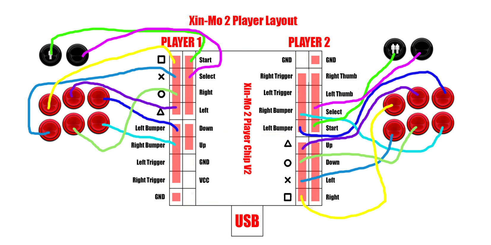

              @Sturgy86 I didn't have this issue. Are you using the Xin0Mo controller? And have you wired up the control unit the correct way? Possibly got player 1 & 2 the wrong way round?
              Here's how mine is wired.
              Built Space Invaders Themed Bartop - Check it out here:- https://retropie.org.uk/forum/topic/5593/space-invaders-themed-bartop-arcade-uk-completed
                Sturgy86
                Ahh thank you, I believe I have got them the wrong way around on the interface, I knew it must have been something simple, I will follow the drawing you have posted.
                Thank you again much appreciated
