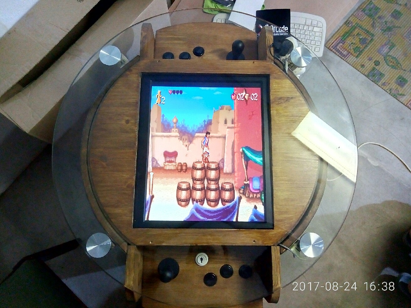

                              I've just completed making my arcade barrel using Raspberry Pie 3b and RetroPie.
                              That how it looks like:)
                              Can I make Retropie interface looks rotated 90 degrees so player 1 can see it in front?
                              theissdevT 1 Reply Last reply Reply Quote 0

                                  • theissdevT
                                    theissdev @vokitak
                                    @vokitak Hrmmm... I've been toying with the idea of a cocktail and trying to figure out the best way to handle aspect ratios (and flipping). This barrel idea gives me an idea - what if you can make the monitor under the glass be pivot-able? Nothing crazy, just from portrait up to landscape left or something? That round base and glass would work great with that. Thanks for the inspiration!
                                    Cocktail Cab Project - https://retropie.org.uk/forum/topic/23763/cocktail-cab-project?_=1592408967951
