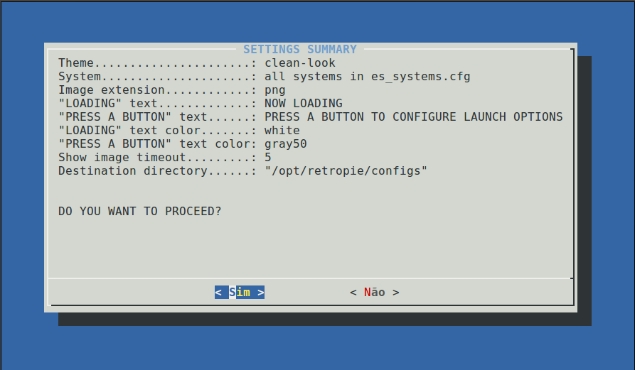

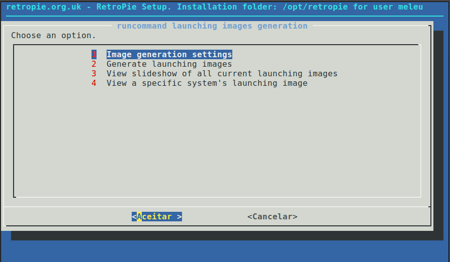

          @BuZz I think I've found what was driving me crazy on the packages.sh commit history. I'm working on a scriptmodule and the installation were working fine, and then I've updated the RetroPie-Setup and the installation stopped to work. Now I see that I have to use the noinstclean flag. Everything seems to be working fine now. Is it enough?
          By the way, the scriptmodule I'm working is a frontend for the launching image generation tool.
          Here are some screenshots of what I have so far:
          Examples of generated images can be seen here.
          Do you think it's worthwhile feature to include in RetroPie-Setup?

            @meleu could do - is the scriptmodule available to look at ?
            Output looks good. nice job.

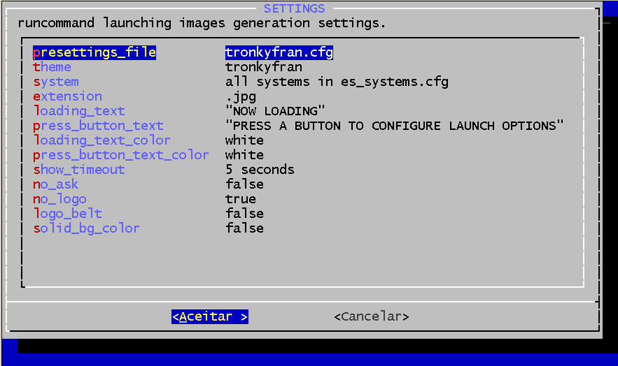

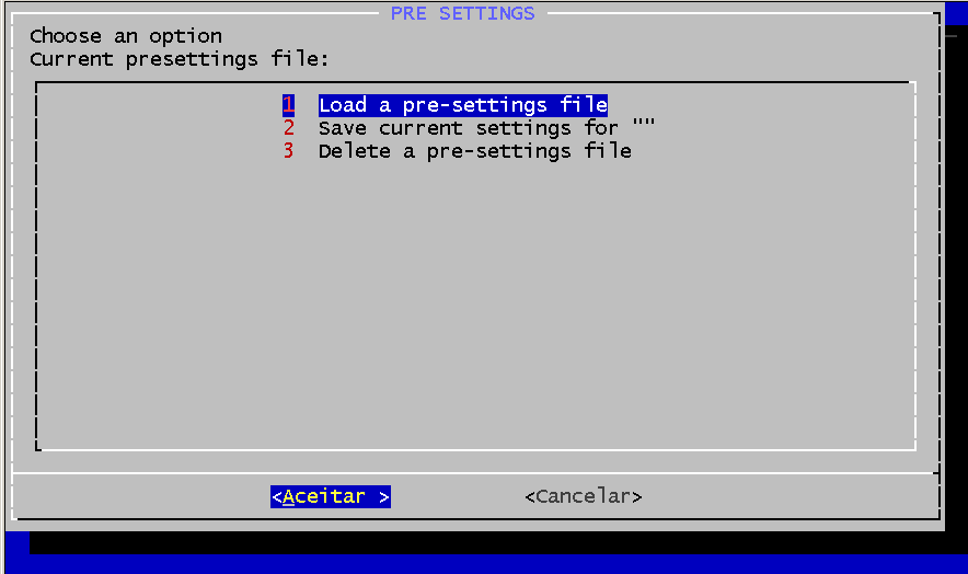

                  I'm always keeping in mind the operation via joystick, then I'm making available a way to load/save/delete config files based on the theme name (this way there's no need of a keyboard to type the filename). Example: custom configs for material theme will be named /opt/retropie/supplementary/launchingimages/material.cfg; for carbon, .../carbon.cfg; etc.
                  Pro:
                  • no need for a keyboard at all.
                  Con:
                  • themes can only have one config file.
                  Are you OK with this approach?
                  Here are some screenshots (took from a Windows+Cygwin environment. I'll post the code as soon as I get home):
