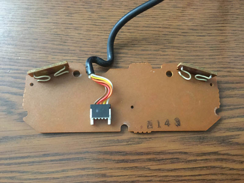

      Converting the Super Famicom controller was really straightforward. Raphnet has extremely thorough instructions(PDF link) on their website and since Nintendo's wire coloring is standardized, I just connected things up, and I was on my way. I chose to use the factory plug, just because really. It looks nice and makes swapping things out easier if I would ever want to, though I don't see that being necessary as these controllers are built like tanks. While I had the controller apart I put in new membranes and washed everything with soap and water.
      Fitting the board inside the controller was a non-issue, and I was able to route the USB cable through the normal strain relief posts. The bottom screw hole was broken when I got the controller, but using it would not have been an issue if it were intact.

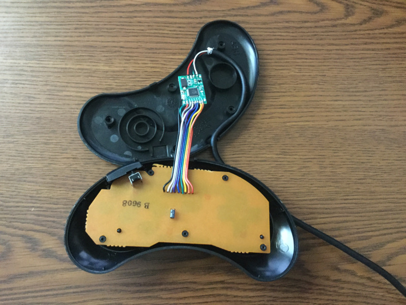

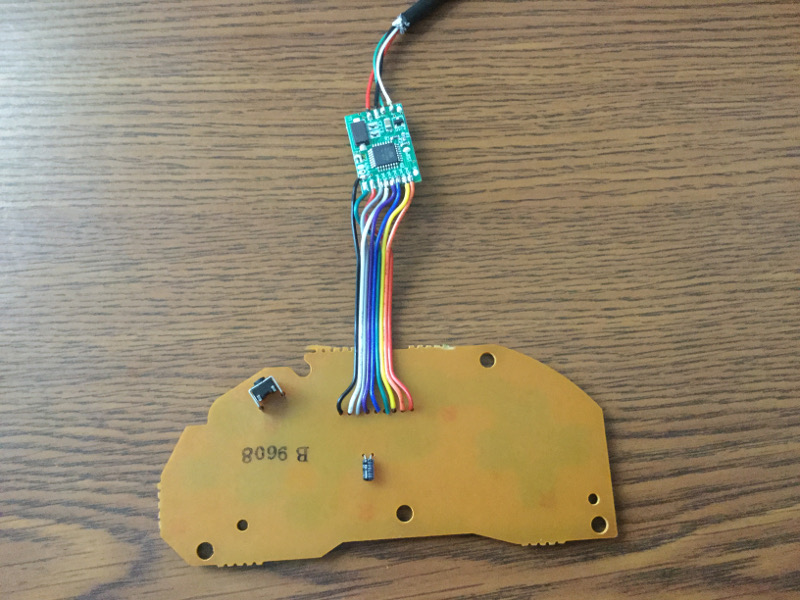

      The Genesis controller proved more difficult, mainly due to me making assumptions. The Raphnet guide mentions that the DB9 controllers don't have standard wire colors, but when I had the controller apart I saw that on the PCB the far right connection had a 9 on it, so silly me, I assumed that the pins went in order.
      I tried to keep the factory connector, but Sega's wires had very thin conductors interwoven with string, so I removed the junky wire and replaced it with some ribbon cable. I soldered the new ribbon cable up to the adapter, and buttons weren't working. jstest was only showing that two buttons were working at all, and things were just not correct. I could have had a bad controller (I had no way to test it before taking it apart), maybe I didn't put the adapter in DB9 mode, what the heck?
      Going back to the instruction manual for the adapter I decided to get out my meter and test the original wire to determine the pinout, and sure enough, yes, the pin on the far right is 9, but the other pins are NOT in numerical order. Below is a diagram of what I determined the pinout to be on my MK-1653 controller. Yours is probably the same, but get out your meter and save yourself the headaches I had.
      Once I had the pins correct, everything else went smoothly.
      Sega didn't use strain relief posts in their 6-button controllers, it was actually a barb in the cable itself. Since my USB cable didn't have that I routed it around the screw post and it seemed to work well.

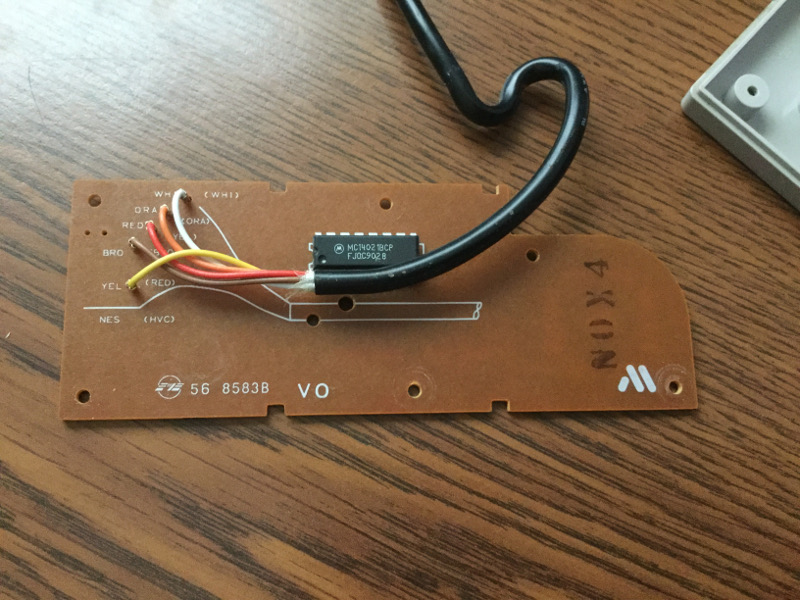

      Since I now had a "spare" Super Famicom controller cable, I decided to convert an old NES controller to use the Super Famicom cable. Thanks to the wonders of the Internet I learned that both systems' controllers were essentially swappable. An article on Instructables had a writeup on making an adapter that I used to map the wiring color differences.
      The NES controller was has 5 wires
      The Super Famicom uses the same 5 wire colors
      This diagram shows how the pins crosswalk between the two systems.
      Soldering up the Super Famicom wiring was easy
      Now I can use a real NES controller plugged into my Super Famicom Pi.
