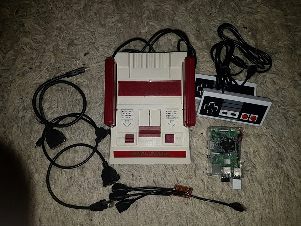

      Few deliveries from the post today, all I'm missing is the Mausberry switch.
      Thought need a new thread as we derailed the other a little.
      Some slight yellowing to the console, but not much, once I take it apart I shall see how it may clean up, so painting is a maybe, stickers are in good condition, and the controller gold is very good.
      Everything in one place to work this out
      Using my current Pi until pay day when I'll put one back in my Mega Drive
      Rest of the shopping, parts list:
      Short HDMI extension
      Short ethernet extension
      Short power extension
      Spare guts from a USB hub, tempted at having a USB at the rear and front as, there's the spaces for them, although I have another 4 port somewhere, which depending on space, and if it can be cut down enough, may look good under the cartridge slot, in which case, I need an old Famicom game to hide a USB stick in

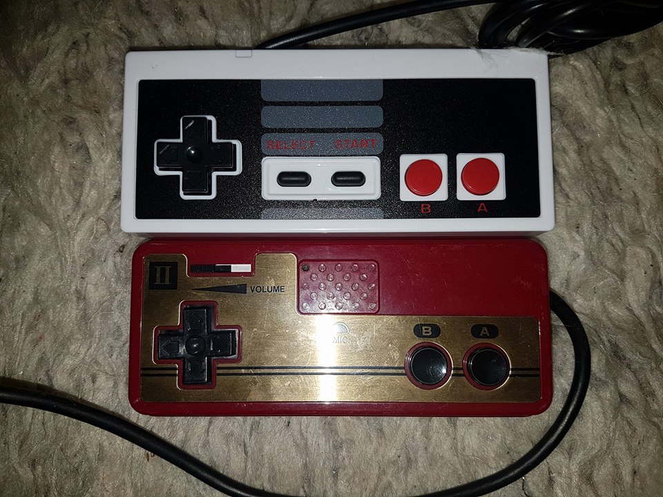

      2 very cheap NES style USB controllers.
      Only had a quick look at the parts so far, well the controllers, I just had to know if...
      They look very compatible
      Some very teeny tiny motherboard compared to the original, and all looks to line up with the Famicom spacing
      Contacts all look good to match as well
      Only difference is, the Famicom board is held by two pegs, one above the B and A buttons, and one above the direction pad, a simple fix to cut them down, then looking at putting a bridge across the two central screw holes to hold the board in place, and maybe some padding behind it to stop it flexing when in use.
      Already a bonus as the new controls have about four feet of lead, compared to the two of the original, and they will largely be for show.
