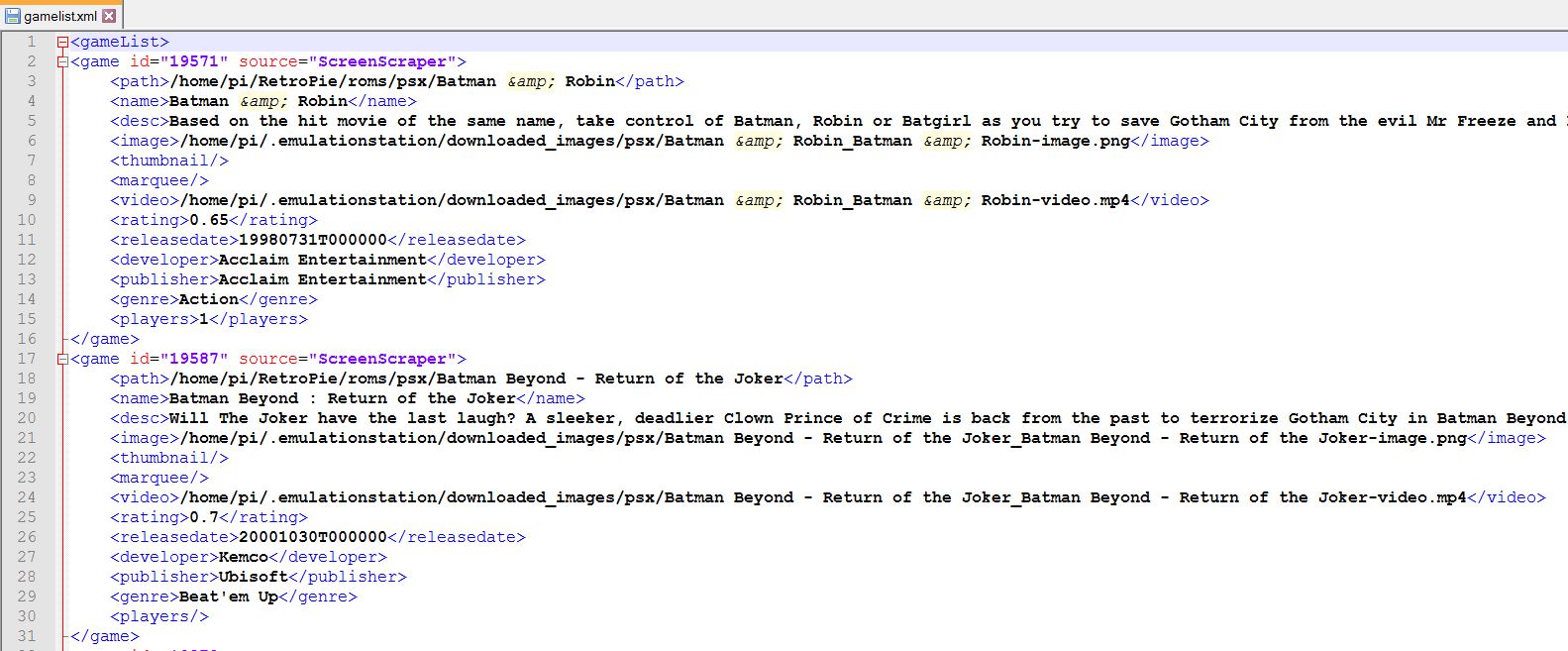

          @pjft Here some screen shot examples of my folder structure and game list. My arcade folder works fine, I can have video themes run video and non-video theme show images all from this game list. 0_1489753698087_NES file struct.JPG 0_1489753788845_NES gamelist.JPG
          Here is my folder structure for PSX and the game list. In this case, no matter what just the image shows up, no video, and the metadata does not work either.0_1489753908868_psx file struct.JPG 0_1489753959275_psx game folder.JPG 0_1489754039807_psx game list.JPG
          Here is my video image/video folder 0_1489754205939_psx video folder.JPG
            pjft @TMNTturtlguy
            @TMNTturtlguy exactly. You're assigning the metadata, image and video to a folder in the gamelist file for the psx, whereas on the NES example you're assigning it to the zips. I'm not sure that is supposed to work.
            The fact is that a folder is not an accepted game type for the psx, so my suspicion is that it won't load that from the gamelist as it's not an identifiable type.
            I'm not sure if that is supposed to work - maybe others will know. If you do want a very hacky workaround attempt, try renaming one of the psx game folders, adding an acceptable extension to it. Say, add .cue to the Batman folder name, and to the gamelist path. See if it is loaded and shows the metadata and videos. Then check that it opens and works as expected. I can't promise, just guessing.
            What I have done in the past is to actually have the individual game files from inside the folder present in the gamelist. The folder itself won't show any metadata, but when browsing the folder it certainly will on the individual files. Unsure if that's what you're aiming for.

              @pjft We are part way there! You are spot on that naming the main folder .cue allows the metadata and video to play.....problem is that the game won't launch. It goes to load and then just exits out. It thinks the folder.cue is executable, but it isn't. Now I need to try to figure out how to tell it to open the folder and launch the file inside....thoughts on that? THANKS for the help on the .cue naming.
                pjft @TMNTturtlguy
                @TMNTturtlguy nope, no thoughts here. That confirms the hypothesis, though.
                I'd revert that change, then, and wait to see if someone else chimes in on a better approach. I have not used that in the past, and yes, it doesn't load because it can't load a folder. The emulator needs to load one of the individual files inside the folders. If it has the extension, it'll open it as a game, to the best of my ability, which is obviously wrong.
                Search the forums and see if others have dealt with that. I've seen people merging multi disc games into a single file - maybe that could be an alternative for you?
                Best.
                EDIT: but you're telling me that, without naming it cue, it showed an image? Is that correct? And was it the right image That you had in the gamelist file? Exactly what fields did it show correctly? Can you take a screenshot of it when you have selected one such folder (not named .cue)? Just curious.
