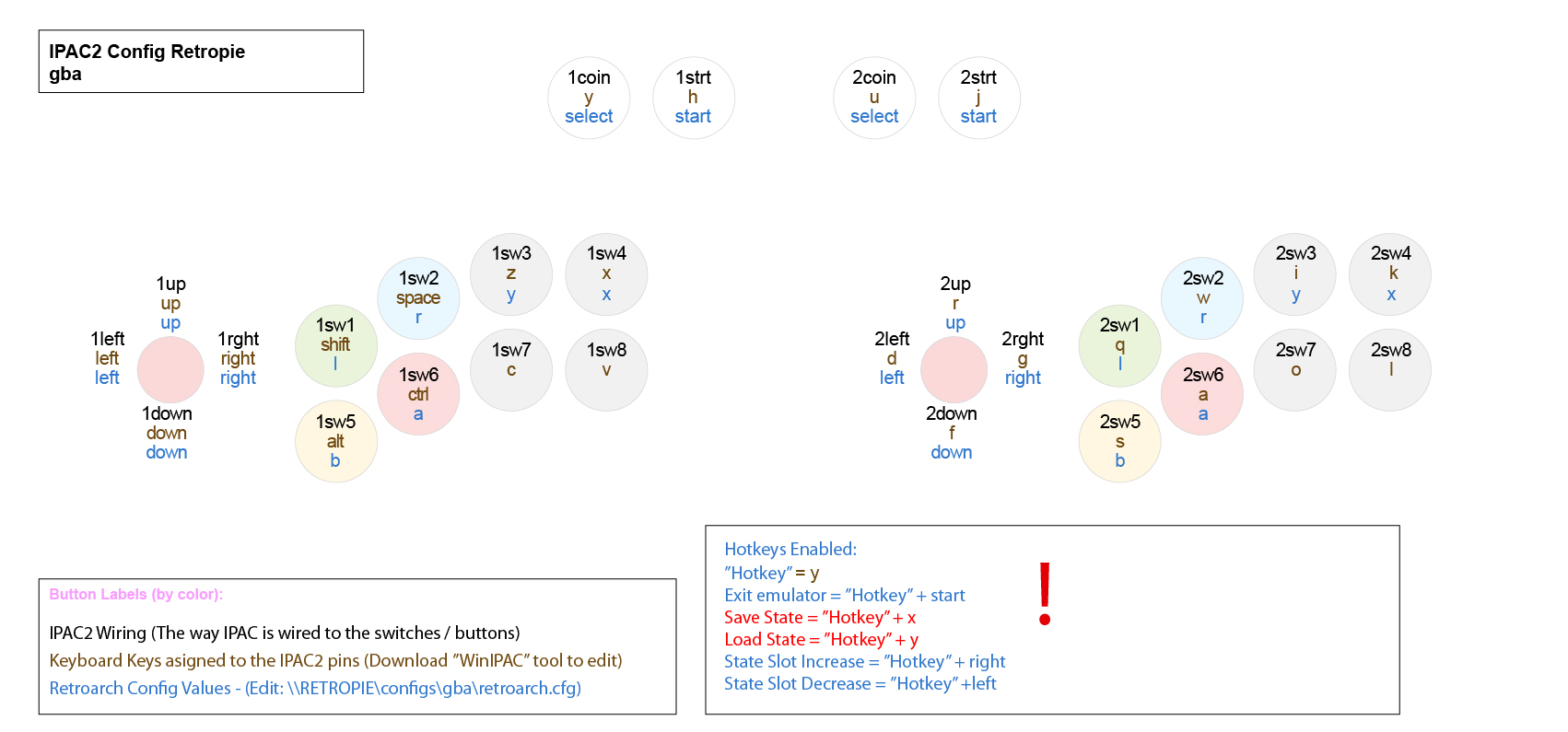

      For this reason, I made myself a visual map of the button layout of each individual console and specific ROMS. The previous two images I showed you are exactly that in an early stage. It is nothing that special really. The template is made in Adobe Illustrator. It contains a set of images, showing the button layout of my arcade and inside each button, there are tree values written. These values tell you the name of the switches, the Keyboard Keys assigned to each switch and the Retroarch key values tied to the Keyboard input.
      I have made a separate copy of this layout for each emulator.
      Here is an example. This is the default retroarch configuration map.
      These controls will be active in the Main Menu of the RetroPie. They will also be automatically assigned to each new emulator you decide to use beside the 8 I’m using.
      Here is a short description of what you should keep attention to in this image:
      • In the upper left corner, there is a title telling you for which Game Platform these controls Apply.
      • The text in BLACK tells you how are the button switches wired to the IPAC2 board. Once set up these values never change.
      • The text in BROWN tells you which Keyboard Keys has been assigned to each pin on the IPAC2 board. Once set up these values never change.
      • The text in BLUE tells you which RetroArch key values are tied to these Keyboard Keys. These values can be rearranged inside the different.cfg files! By making copies of the default .cfg file and rearranging the values in BLUE you are switching the buttons functions for each emulator!!!!
      • Button Labels section is basically a legend. Take notice of the blue text, though, as it will tell you in which directory you should copy the edited .cfg file!
      • Hotkeys Enabled section. RetroPie has a set of shortcuts for hidden functions like saving/loading a game and others. These functions can be disabled for specific gaming platforms or changed in such a way to keep being constant even if you have rearranged their position while editing some of the other buttons.

      2. System Specific Configuration
      I want to give you one example of System Specific Configuration, which will demonstrate for what reason and how are the Retroarch Config Values rearranged on the button panel.
      For that reason, I will use the Game Boy Advance mapping as an example.
      Navigate to this file and open it: /opt/retropie/configs/gba/retroarch.cfg
      You will see this written in it:
      # Settings made here will only override settings in the global retroarch.cfg if placed above the #include line
      input_remapping_directory = "/opt/retropie/configs/gba/"
      #include "/opt/retropie/configs/all/retroarch.cfg"
      First, take notice of the input remapping directory path.
      For each system, it is different and reflects the file location.
      Second, take notice that because there is no Player Input commands written above the #include "/opt/retropie/configs/all/retroarch.cfg" line the controls assigned to this emulator come from the Global Configuration file.
      To change them you will first have to paste the Player Input values from the Global Configuration file and edit them.
      But before that… why edit them in the first place?
      Look again at the image from Step 3. Then look at the image from Step 6.
      If I use these controls when I play Game Boy Advance game I will have to play with the RED and The YELLOW buttons for A and B respectively and the top two BLACK buttons for L and R. I would prefer to assign the L and R buttons to the GREEN and BLUE buttons.
      I also want to disable all buttons I’m not using. To “nul” them.
      These will be L2 and R2, but not X and Y as when they switch position with L and R they will keep acting as HotKey buttons evoking Save/Load functions.
      Look at the GBA Configuration Map:
      And now compare the code:
      Simple enough.
      These are really the basics.
      When you are done with the file editing copy the new files over the ones in the original directory on the SD card.
