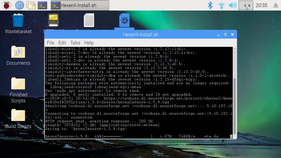

      Build process:
      1: Download and install necessary required libs for SDL, Timidity and etc.
      2: Create folders Games and Hexen II with full path /home/pi/Games/Hexen II.
      3: Download uHexenII source files and 1997 Nov. demo of Hexen II.
      4: Compile uHexenII.
      5: Move pak0.pak file from 1997 Nov. demo of Hexen II into /home/pi/.HexenII.
      6: Create .desktop as a shortcut on Raspbian desktop and create Hexen II.sh file into Ports folder in RetroPie.
