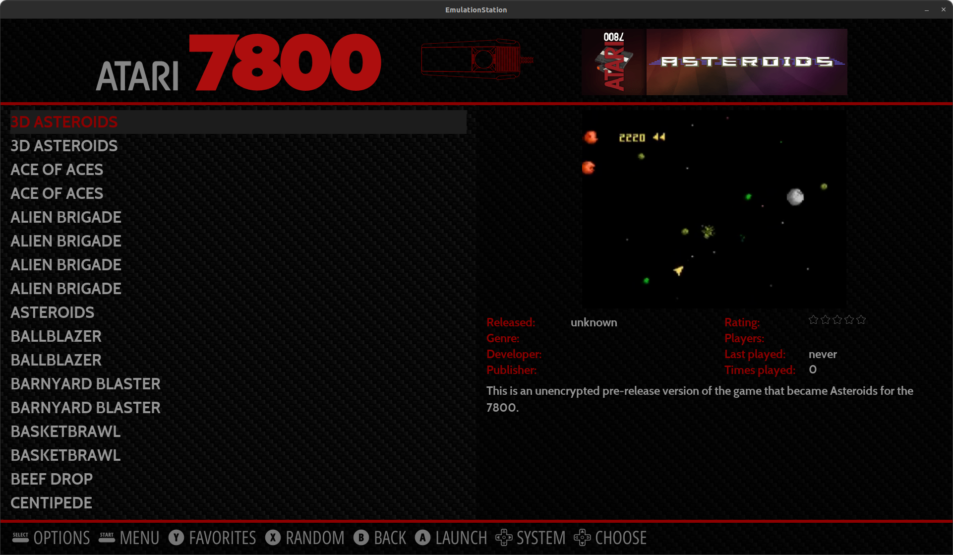

                                    @Folly Hi Again! I'm trying the subfolders, and it is somehow working, except that I have a starnge behaviour from emulationstation:
                                    This is a snippet of the created gamelist:
                                            <game>
                                                    <rating></rating>
                                                    <name>3d Asteroids</name>
                                                    <marquee>./marquees/3D Asteroids (1987) (Atari) (Prototype) [a1].png</marquee>
                                                    <image>./images/3D Asteroids (1987) (Atari) (Prototype) [a1].png</image>
                                                    <publisher></publisher>
                                                    <releasedate></releasedate>
                                                    <players></players>
                                                    <video>./videos/3D Asteroids (1987) (Atari) (Prototype) [a1].mp4</video>
                                                    <genre></genre>
                                                    <path>./myroms/3D Asteroids (1987) (Atari) (Prototype) [a1].zip</path>
                                                    <developer></developer>
                                                    <thumbnail/>
                                                    <desc>This is an unencrypted pre-release version of the game that became Asteroids for the 7800.</desc>
                                                    <playcount>0</playcount>
                                                    <lastplayed>0</lastplayed>
                                            </game>
                                    So roms in subfolders are detected and integrated into the gamelist, even in relative mode.
                                    BUT, see emulationstation:
                                    and when I enter the 'myroms' subfolder:
                                    Is this the expected behavior from emulationstation?
                                    (same behaviour when using absolute paths)
                                    Anyway, just added the --recursive flag that will do exactly that, recurse over subfolders in the systems path. Let me know when you have a chance to test it. I do not know how to remove those subpaths in emualtionstation menu though.

                                      Nice ;-)
                                      Yes, it works with and without the option --relativepaths.
                                      Though I am missing that the script will not display what's being recognised.
                                      The subfolder behaviour is expected.
                                      Subfolders are shown when they contain roms.
                                      Dependant on the theme they are mostly showing up as gray text in emulationstation.
                                      Obviously such folder has to be there otherwise you can not select a rom from a subfolder.
                                      As far as I know it's possible to add media to a folder just like it's done with files but for the folder no media has been added in the gamelist.xml now.
                                      kiroK 1 Reply Last reply Reply Quote 0
