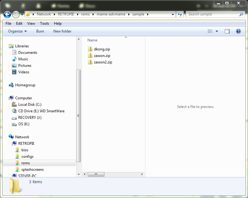

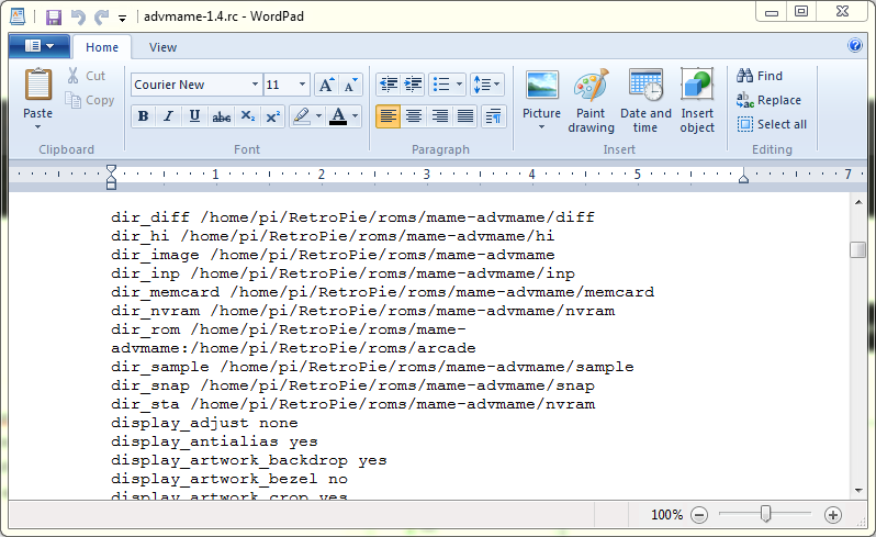

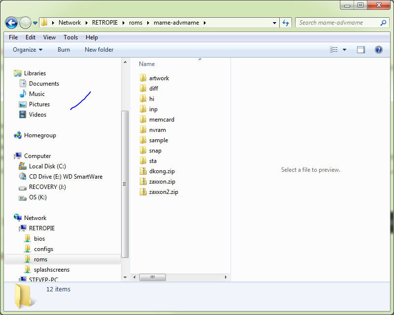

      @caver01 Here is some screenshots of advmame setup:
      0_1495481806526_advmame.PNG 0_1495482115644_advame2.PNG ![0_1495482194901_advmame3.PNG](/forum/assets/uploads/files/1495481714818-advmame3-resized.png
      Still not working but plays fine on my pc. I'd appreciate you taking a look see. I think everything is in the right folders.

        Here is the config file .It didn't upload with my last message0_1495482500386_advmame3.PNG

          @stevep Create a file called samples or re-name the one you have called "sample" or change the file path in the config to point to the correct directory.
          EDIT: I see it is . But try changing every thing to "samples" mine works like that.

                  Yes...I don't quite follow your last post .The rc file reads
                  dir_sample /home/pi/RetroPie/roms/mame-advmame/sample
                  That's where I put them...also when I open the emulator on retropie it tells me I have a game called sample....

                      @stevep You have the files in the correct place as far as I can see. It does not have to be plural "samples", it just has to match the path that is listed in the .rc file. Make sure you are launching with 1.4. Then, check your sample file size. It may differ from the one we have been talking about above, since the romset for advmame is different.
