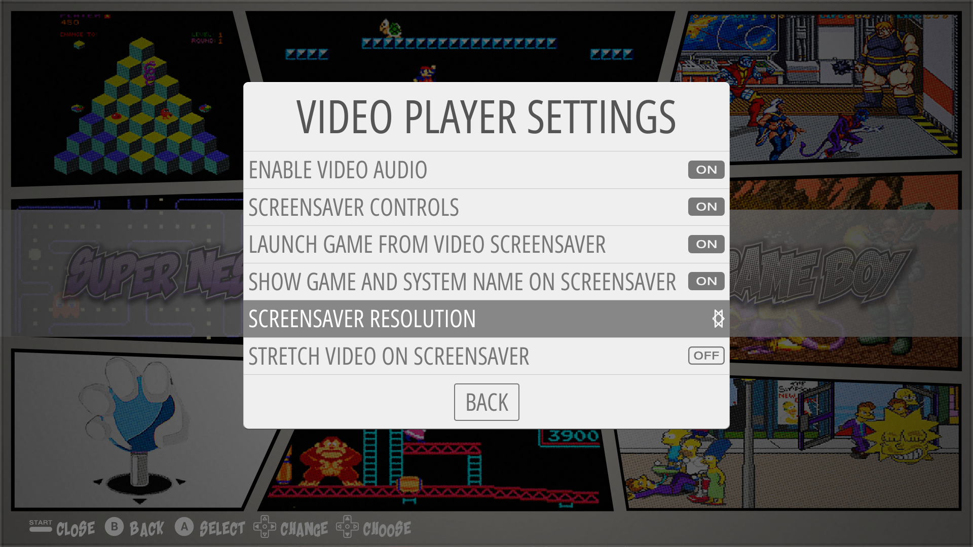

        @pjft My notes about the tests I did this evening (RetroPie on Linux Mint x86).
        1. The default option isn't displayed on the menu in the first run (the 2 overlapping triangles look like the star of David :P )
        0_1496715832179_Captura de tela de 2017-06-05 23:22:24.png
        Suggestion, if you're going to provide just 2 options, I suggest to use a boolean ON/OFF option (just like the other options in the VIDEO PLAYER SETTINGS). It could be named SCREENSAVER HIGH RESOLUTION.
        1. When running with SCREENSAVER RESOLUTION: FAST and STRETCH VIDEO ON SCREENSAVER [OFF], the video overlaps the theme and part of the theme keeps being displayed at borders:
        0_1496716187070_Captura de tela de 2017-06-05 23:25:43.png
        Also, I noticed that the captions with the name of the game are displayed only for ~5 seconds. The Double Dragon screenshot above has no captions because it was taken after those 5 sec.
        1. When running with SCREENSAVER RESOLUTION: FAST option and STRETCH VIDEO ON SCREENSAVER [OFF], the video stretches and again, captions for ~5 seconds.
        0_1496717148992_Captura de tela de 2017-06-05 23:30:11.png
        1. When running with SCREENSAVER RESOLUTION: HIGH there's no difference if STRETCH VIDEO ON SCREENSAVER is ON or OFF and there are no captions at all. IMHO there's no difference between these three modes: RESOLUTION: FAST/STRETCH [ON] and RESOLUTION: HIGH/STRETCH [ON/OFF] (except the captions absence when RESOLUTION: HIGH).

            pjft @Hex
            @Hex @meleu
            Thank you very much for the testing! This is helpful.
            The black background is actually my fault - when I added the non-stretch option for VLC and tested it here it works because I do have the black background code running, but it's only being used on the Pi :)
            The star in the options is caused because, since I removed most of the options (and renamed them!) you had a now-invalid value in the settings file ("fast" and "high" were new - you probably had "native" or "highest" there). This will not happen on release, as there is effectively a default being set, but only if you don't have a value in your settings file. :) Thanks for catching that though!
            As for your missing captions on highest resolution, I do have to say that completely bums me out :( First, then, I will likely have to set the default to "fast" then, and/or rename the options to something more reassuring.
            Out of curiosity, though, what is your screen's resolution?
            Also, great catch on the "Resolution high" forcing the video to stretch. I will fix that!
            Thanks!

                    meleu @pjft
                    @pjft my laptop resolution: 1920x1080.
                    More notes I would like to make:
                    • As my video snaps are all low quality, I can't see any difference in video quality between the two resolution options. Does it have difference on your end?
                    • Maybe SHOW GAME AND SYSTEM NAME ON SCREENSAVER can be simplified to SHOW GAME INFO ON SCREENSAVER.
                    • I would like to see the game info all the time. I don't think users will wait screensaver to watch the videos as a video clip and wait until it ends... My use case for this feature is: a BBQ in my home and the arcade turned on all the time. When there's no one playing, the screensaver is showing some game's video snaps. When a passerby walks through the arcade machine and enjoys what he's seeing, he'll like to know the name of the game (and probably play).
                    • Since it's a screensaver, I think the "stretch video" should be on all the time (no black bars on the sides).

                        pjft @meleu
                        @meleu Darn. 1920x1080 is also the resolution I had tested it on the Pi. No luck, then.
                        Replying to the notes:
                        • No, it won't have any difference on the video itself, but it should render the text much sharper. The difference is:
                          • One option will render the video in VLC at its resolution (let's say, 320x240) and add captions at 320x240 resolution. The upscaling will then be done on ES, via the texture. The video will be rendered full screen, but the captions will show as upscaled blocky text - as you currently have it. This is less CPU intensive.
                          • The other option would force VLC to render the video at the full screen resolution (let's say, 1920x1080), and render the captions at that resolution. The video wouldn't have any perceived difference to the user, but the captions would look sharper as they had been rendered at a much higher resolution. This is more CPU intensive, though.
                          • An easy way to see what I'm referring to is to run the screensaver on the Pi, with the game info on. You'll see what I'm going for.
                        • I like the text change - will use that instead.
                        • As for the game info, I get where you're coming from. However, just for perspective, the videos will cycle every 30 seconds. As I mentioned, the game name shows during the first 8 seconds, and the last 4 seconds - so, 12 seconds out of the 30 seconds. In the worst case scenario, someone who takes a peek at the video and likes what they see, will have to wait 18 seconds to see the actual game name, though on average the time one would need to wait to see the game name will be 9 seconds. In 1/3 of those occasions they'll look at the video and the name will be showing, though. :) So it doesn't feel like a tremendous amount of time to wait. I added the captions precisely because of that use case, but having them permanently on the screen ended up being somewhat ugly, especially for games with longer titles. I am not keen on making that the default, and I'd hesitate to add an option to make it on all the time just because it's "yet another option" (though it's a possibility), so I'd probably suggest trying it out for a while and if after a few weeks that still bothers you a lot we can definitely change it at that time. Though, thinking about it, I can instead make if a selection of "Never/Normal/Always" instead of ON and OFF if it's something that critical. Let me know.
                        • On the screensaver and making "stretch video" as the default, I do have to say I hesitate about that. I'm open to suggestions on that default. The main reasons that that is not the case is that, in particular for vertical games, it looks atrocious, and it does not match the actual game when the user chooses to launch it. I'm not that fixed on this particular default - as long as the option is there - so do let me know what your thoughts are and that's a simple change.
                        @Hex : I'll add that then. Thanks. As for the edge case, it will likely be a very rare occasion - that, truth be told, will be changed as soon as the user changes video - so if fixing that requires a lot of work, I'd not insist on it.
                        Thanks all!
