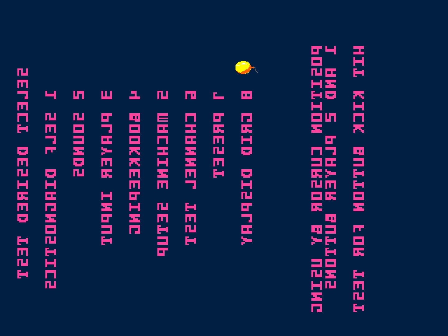

                          Ok Dragon Spirit that worked perfect but Kick I can't figure out still. Here's a pic of what Kick looks in Service Mode (the screen is flipped as in the writing is backwards and also it's on it's side) and I can't get any response from any keys once in Service Mode. It's easier to read if you tilt your head sideways. :)

                              Also Arkanoid I can't seem to figure out either. Dip Switches are either Low or High but none seem related to the screen.
                              both cores are going through some updates in the retroarch side. I will look into this more when the code base stabalises. What system are you using for your test. Retroach/ rertopie x64 x86 or the pie. I get a feeling something does need fixed on kick to be honest.
                              use kicka is working
                              GAME( 1981, kick, 0, mcr1, kick, kick, ORIENTATION_SWAP_XY, "Midway", "Kick (upright)" )
                              i think that is causing it
                              RiverstormR 1 Reply Last reply Reply Quote 0
