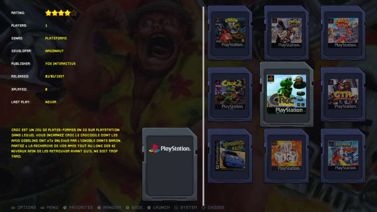

                                • A12C4A
                                  A12C4
                                  Just wanted to see what this cool theme could look like with the grid view.
                                  Grid view wiki

                                      @A12C4 Ha cool :D. There doesn't seem to be much in the way of information on building themes. Grid view sounds nice.
                                      @darknior : I previously had 96 systems setup (most with just dummy roms so they would appear). Perhaps it's an issue when you have that many but I have a feeling it's not. I say this because the issue I had went away when scrolling further on which meant that it must clear memory at some point during the list cycling (guess). Do you not have a different Pi to test on?
                                      A12C4A darkniorD 2 Replies Last reply Reply Quote 0
                                      • A12C4A
                                        A12C4 @Dal1980
                                        @dal1980 It's not on the stable branch yet, that's why you didn't see any reference to the grid in the theming documentation.
                                        Grid view wiki
