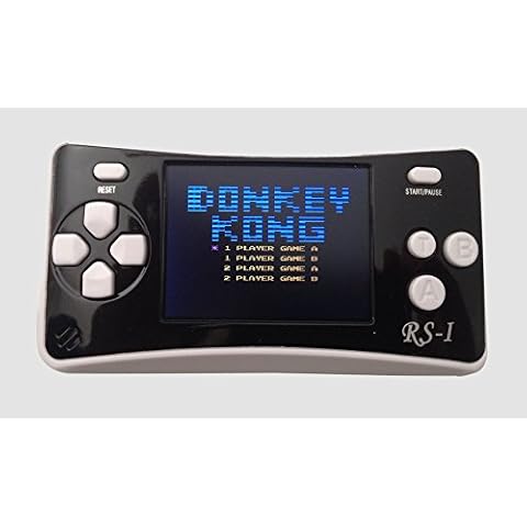

                        So the postman came!
                        Toys!
                        It's actually closer that I thought size wise

                          @moosepr said in Yet Another Pi Zero Portable!!:
                          Toys!
                          Whoa! Nice! Almost a perfect fit. But then, seems like you need at least a 3.2" screen. Maybe a 3.5" would be best but you'd need to go composite for that size up, gpio 3.5" screens @ 320x480 are too slow.
                          • mooseprM
                            moosepr
                            Yeah the original screen is 2.9" so if I bump the screen up to a 2.8" SPI screen, I will keep the same resolution and it should just drop in.
                            I had a stroke of luck with the buttons, the top of the rubber conductive buttons are exactly the same height as my silicone topped switches. I think I'm going to cut some non conductive sheet of some kind to the same shape as the current motherboard and wire them all in that way.
