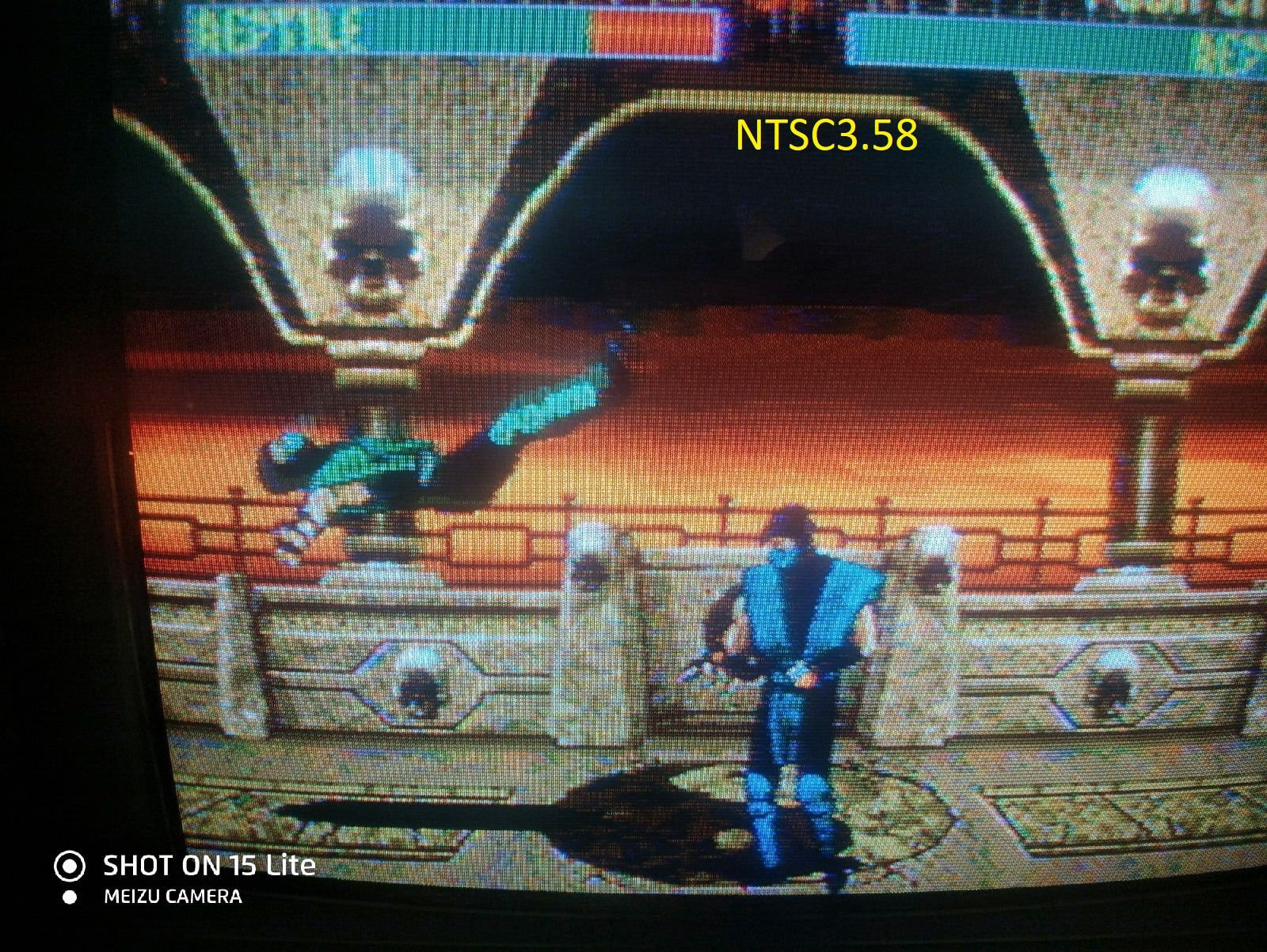

                          • I
                            IGA @IGA
                            Update:
                            so, i think....
                            I have color in my NTSC3.58 - but it's incorrect ( green not green, purple not purple and etc.... cause NTSC3,58 is not true NTSC)
                            (Maybe my cellphone not shoot in true\sharp color, but Reptile on second photo is blue....)
                            So, i think.... maybe i need some patch\fix for ntsc3.58 colors at all ??
                              mitu Global Moderator @IGA
                              @iga said in retropie on composite tv-out (wrong colors or wrong picture at all) How to config?:
                              I'm not aware of anything that can correct that.
                              I 2 Replies Last reply Reply Quote 0
