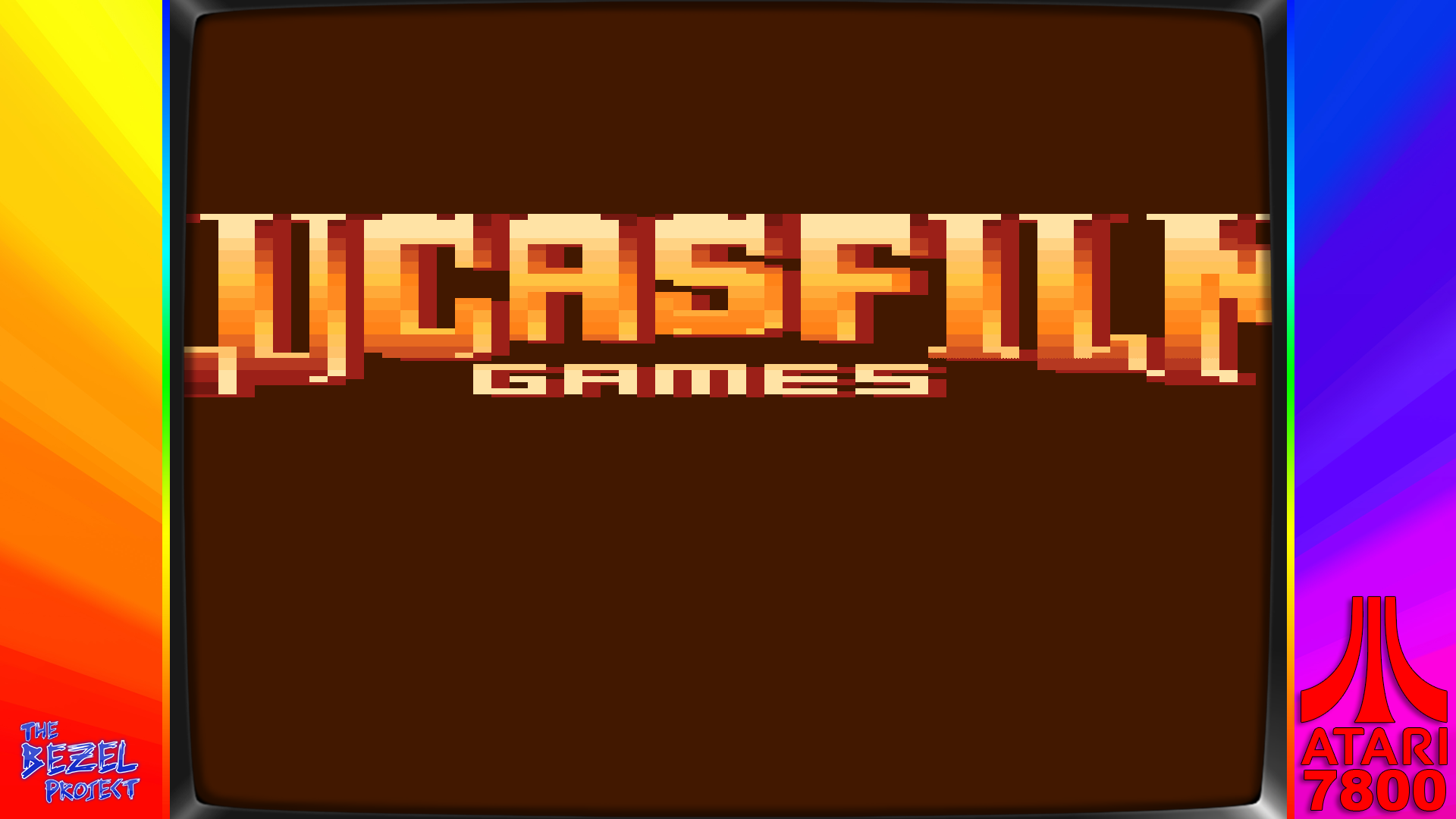

                  Here is the overlay / bezel currently be shown, it's not the game bezel it's the console default which I don't want.

                      ...and the undesired (Arcade) Bezel:
